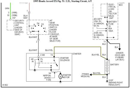

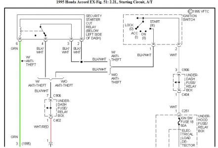

Recently my 1995 Honda Accord would not start, I jump started it & left it to idle a bit, came back & smoke was coming form the hood. The starter relay & its connector had melted. I bought a new one (Mitsuba 2201) & I need to reconnect it but I do not know which wires (two red, one black & white wires)go to what terminals on the relay??? Are there any wiring diagrams or drawings[img:d0e23f59cc]http://www.2carpros.com/forum/automotive_pictures/343770_Mitsuba_2201_Relay_2.jpg[/img:d0e23f59cc]
Apr 13, 2009 at 8:49 AM
KHLOW2008
  • 41,814 POSTS
Hi mdby2k, Here are the schematics. Starter system does not utilise relays for starting except a disabling relay controlled by the security system. Are you sure the damaged relay is for the starter?
https://images.2carpros.com/forum/automotive_pictures/192750_StartCircuit95AccordAT01_1.jpg
https://images.2carpros.com/forum/automotive_pictures/192750_StartCircuit95AccordAT02_1.jpg

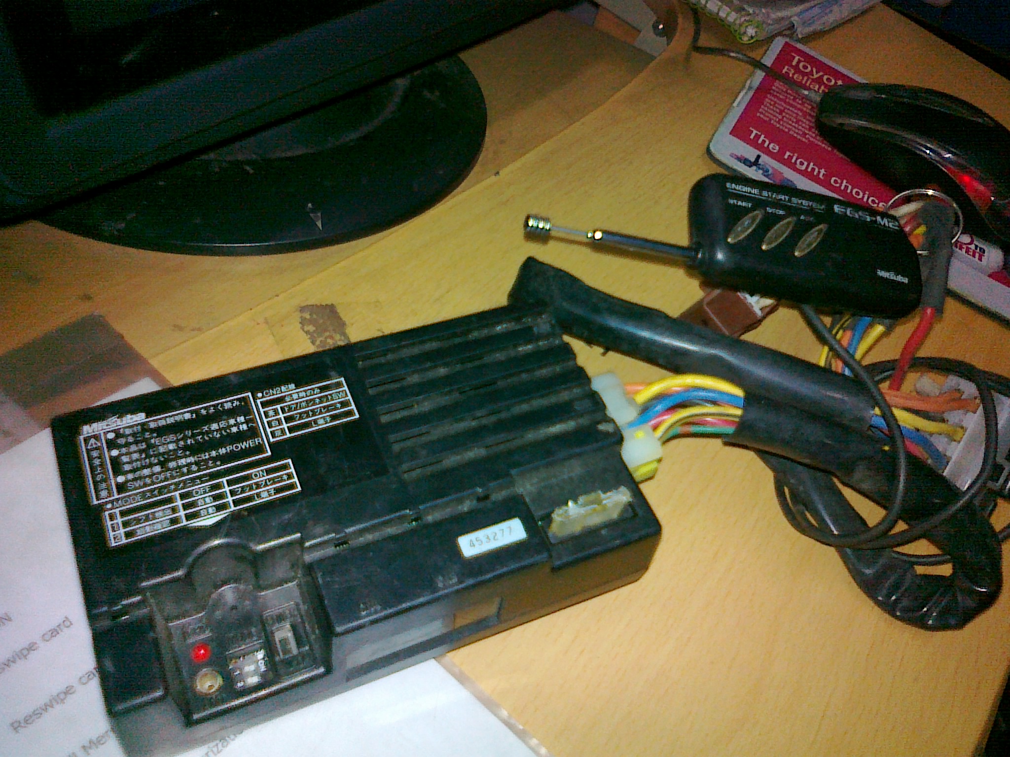

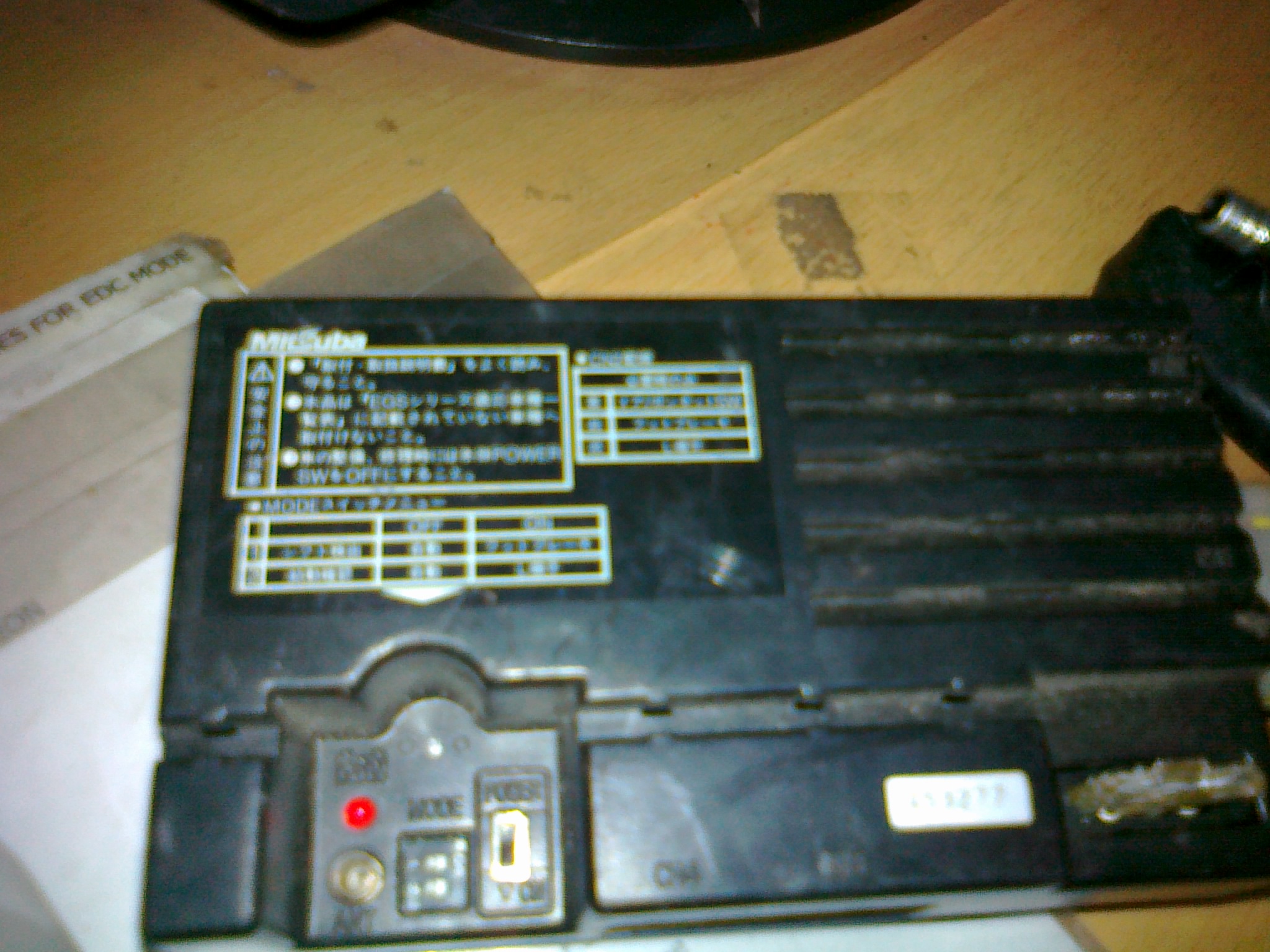

hi! can anyone please give me a copy of mitsuba main relay assembly RZ-0088 wiring diagram? It's the one used for Honda Accord 1997 model. Thank!
Jul 6, 2012 at 11:06 PM
JERSON

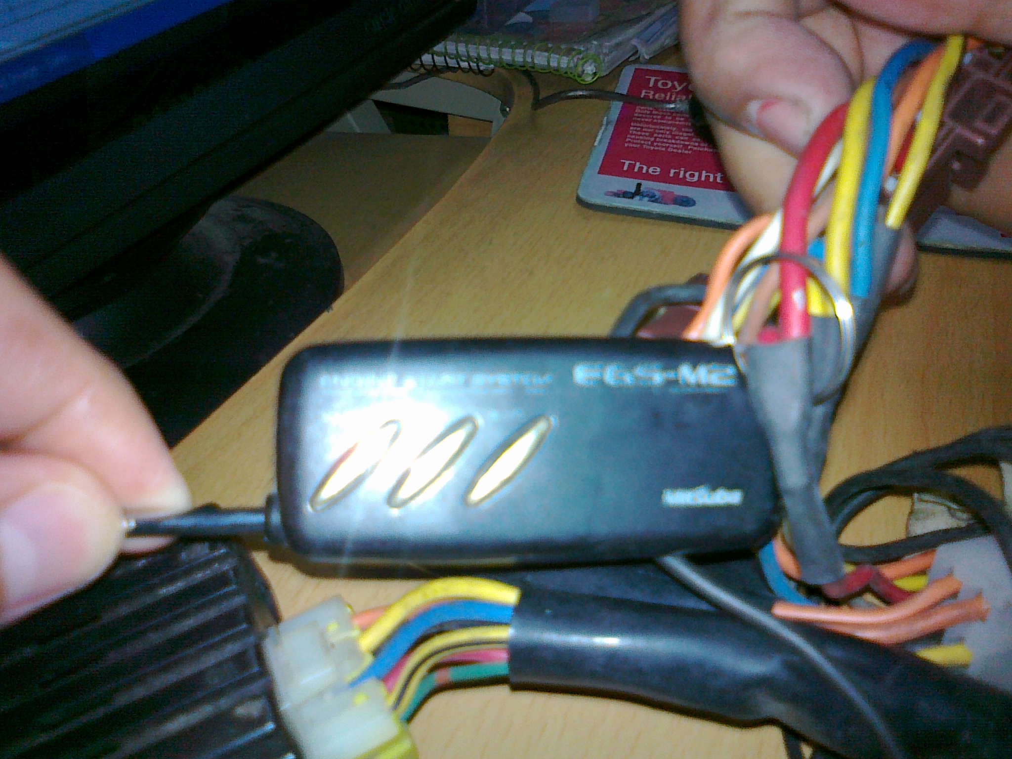

hi, im jerson, please can i have a wiring diagram of MITSUBA ENGINE START SYTEM EGS-M2?, for my honda fitt. kindly see the attached file of the unit.
