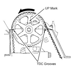

I need to know the timing marks for a 1995 honda accord. I put a new head on and need to get it in time.
Monday, January 28th, 2008 AT 7:29 PM
BMRFIXIT
MECHANIC
19,053 POSTS
This is what i have for 2.2l
hope that help
