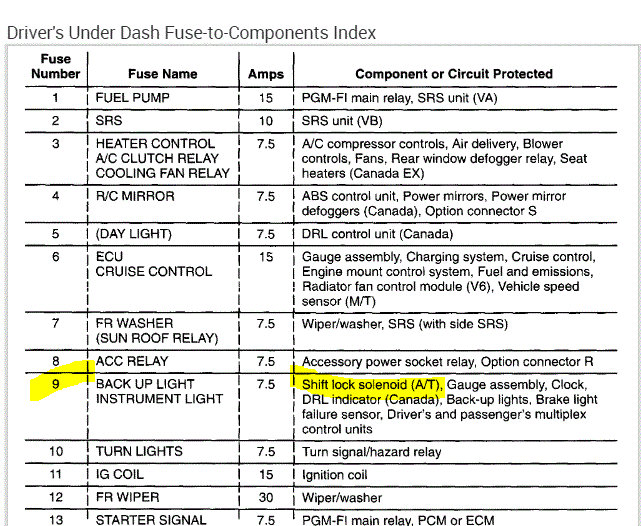

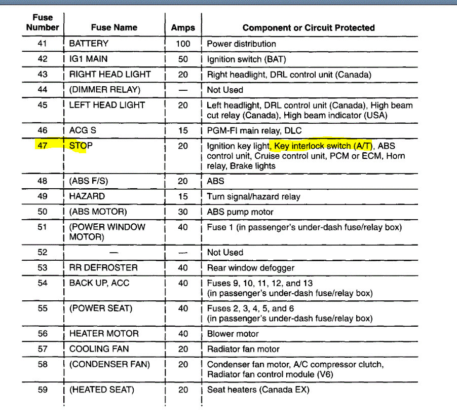

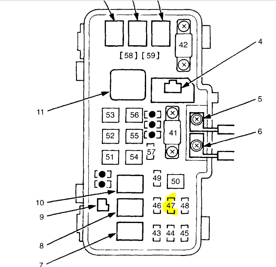

I can't switch my car into gear made a loud alarm noise for about 10 minutes while I was driving.I had to take a part the middle console and have to use a flat head screw driver in the hole that say manual release shift and then my car will change gears and drive. But without I can't get it to switch gears it's like I'm locked out. Can you help me? I do not know what to do.
Sunday, June 7th, 2020 AT 1:22 PM
25 Replies
  • 109,983 POSTS
If you can't shift into gear from park, there is an issue with the park interlock system. Don't laugh, but do the brake lights work properly? The release actuator receives power from the brake light switch to release. Battery voltage is supplied at all times through "fuse 47" to the brake switch. With the ignition in "on" (II) or "start" (III), battery voltage is supplied through "fuse 9" (in the driver's under-dash fuse/relay box) to the shift lock solenoid.
This is where I would start. I need you to check both of the fuses I indicated. I attached a few pics to help with identification. Let me know if they help. Also, here is a link you may find helpful:
