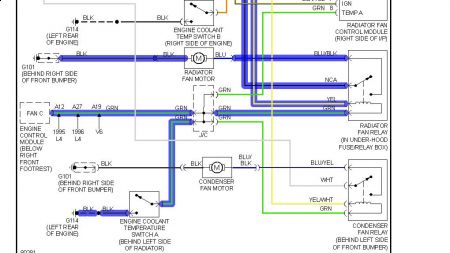

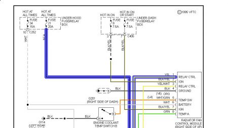

Does anyone know a fix for a fan that runs on a cold car, we have checked all three sensors, and they all work. I have remove the relay to turn the fan off to prevent my battery from dying. Someone please HELP!

Could be a short circuit in the wiring see below
https://www.2carpros.com/forum/automotive_pictures/12900_h1_7.jpg
https://www.2carpros.com/forum/automotive_pictures/12900_h2_7.jpg
