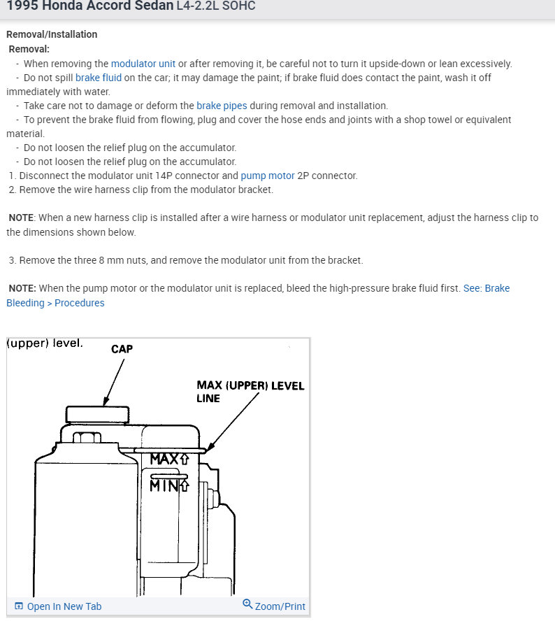

Need step-by-step for abs pump install
1995 HONDA ACCORD
166,500 MILES • 4 CYL • FWD • AUTOMATIC
MANNY3700
  • 6 POSTS

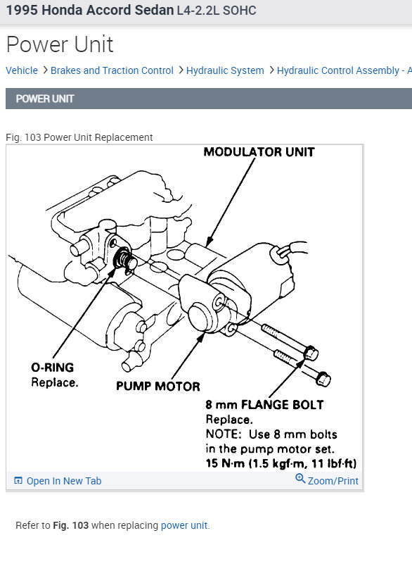

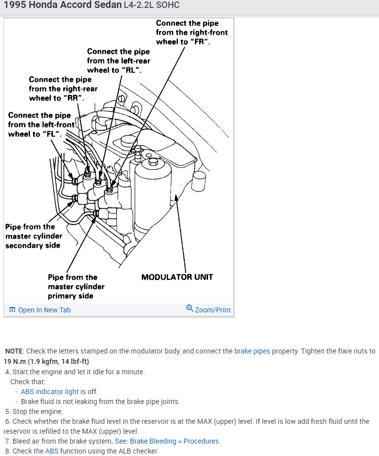

There is no pressure the pump just comes on and then turns off. Then the ABS light comes on the dash and stays on. I have had the codes scanned on it at a shop, and they said the accumulator is leaking. But it could also be the abs pump. They also made a note that the brake booster for the normal brake system was leaking some brake fluid. I purchased a used, tested and functioning abs pump from online and need help installing this. Any help will be greatly appreciated in this situation.
Feb 15, 2009 at 2:28 PM
SQM
  • 6,383 POSTS

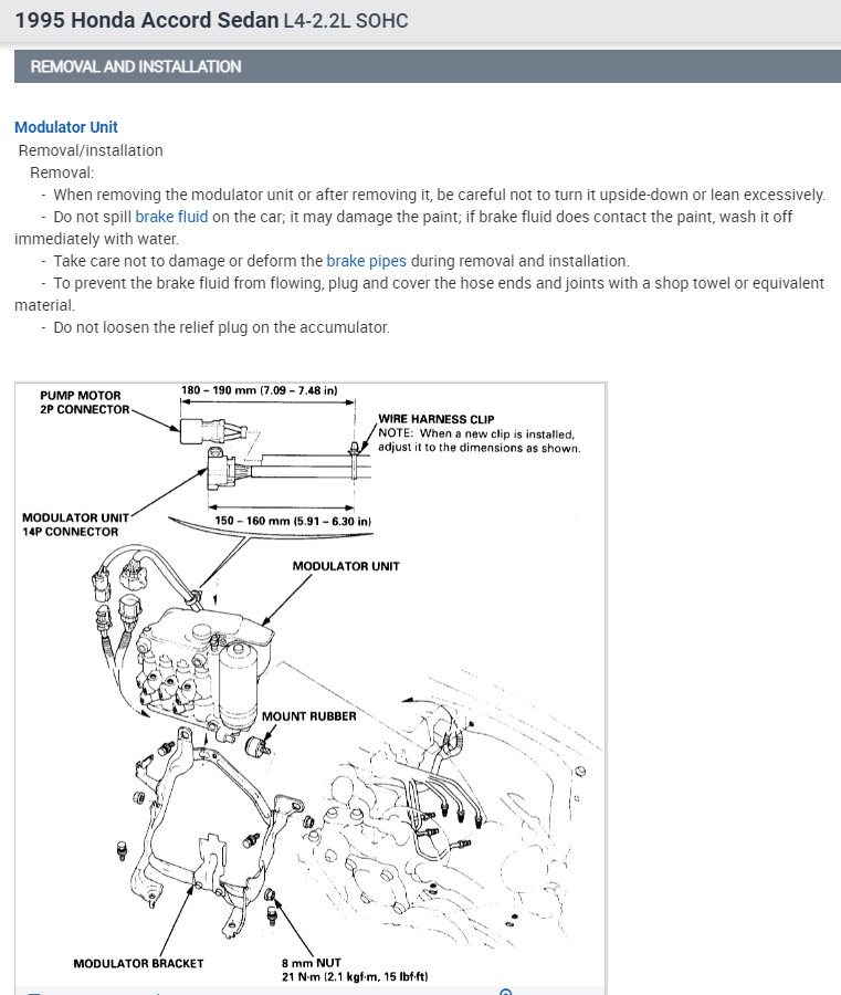

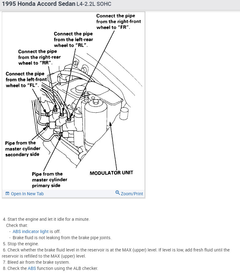

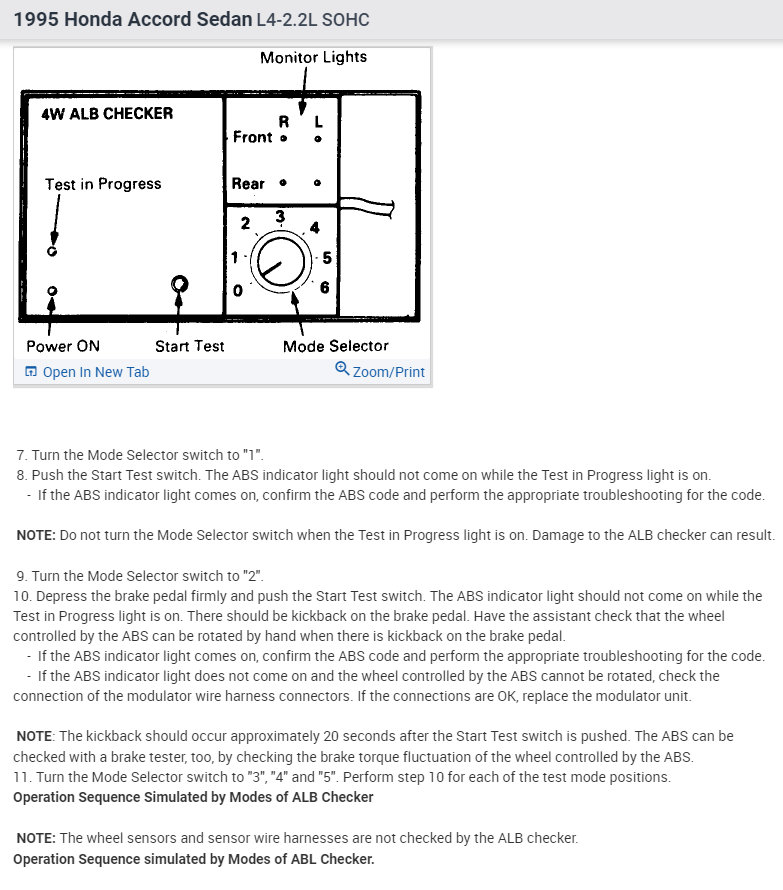

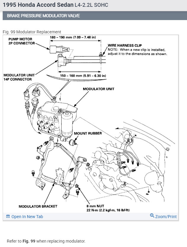

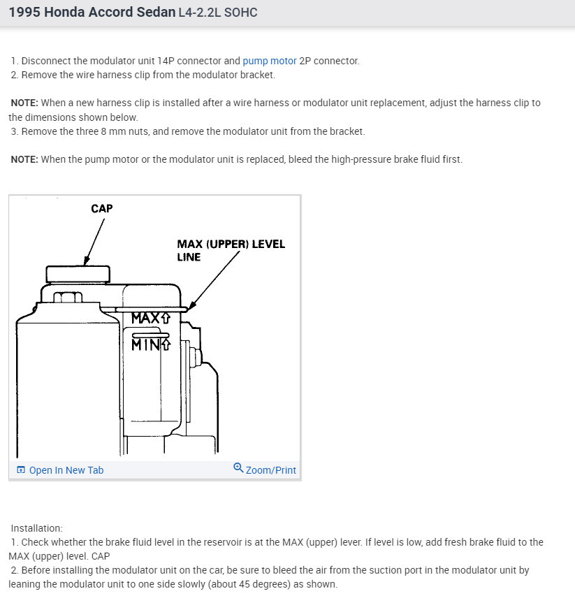

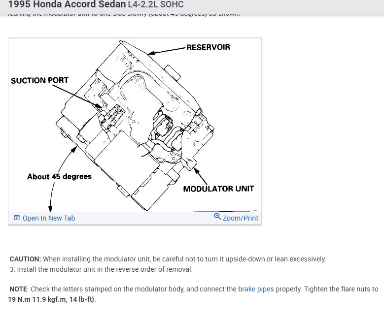

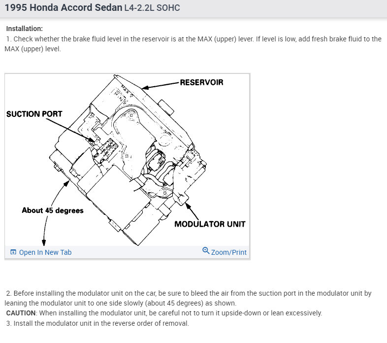

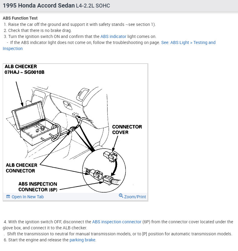

I have attached the complete procedure for the ABS modular unit and pressure module valve.
Please note that you will need a social scan tool in order to properly bleed the ABS system after the install.
Here is a helpful video:
https://youtu.be/nQRnKyVyMuQ
