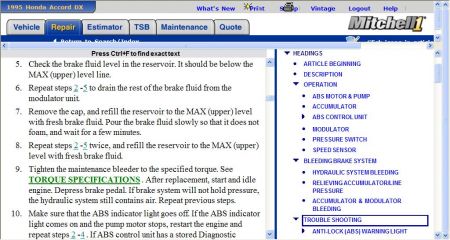

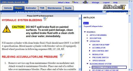

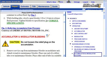

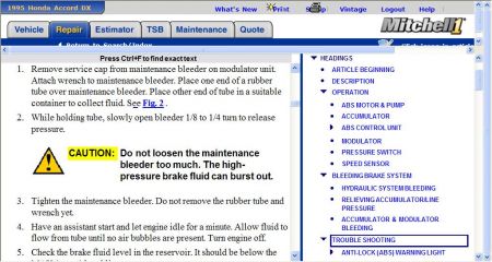

What is the proper way to bleed the brakes. Inspection of the entire brake system indicates sound condition; however pedal very low and spungy. Appeared to be operating on one circuit so I replaced MC and bled the brakes in the traditional manner Pedal still low and spungy! Does the ABS system require bleeding too?
Sep 17, 2008 at 6:50 AM
  • 75,992 POSTS
Bleeding sequences RR/LF/LR/RF with ABS
