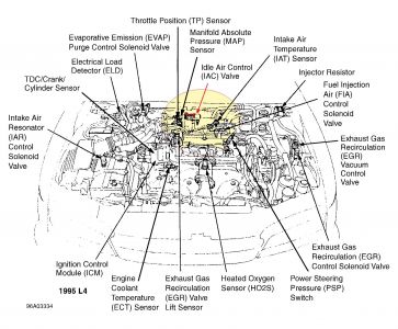

I am having trouble locating the IAT sensor on my car. I have a diagram of the engine that says where it is, but the picture is small and not 3D, so locating the postion of it is hard especially sense I am not sure what the sensor looks like or where it attached. I guess what i am looking for is a detailed description of its placement in the engine department.(i.e. Over, behind, between, next to) thank you[img:9cc6e2fddc]http://www.2carpros.com/forum/automotive_pictures/209868_1639_IAT_1_1.jpg[/img:9cc6e2fddc]

Its located at the intake manifold just pass the throttle body

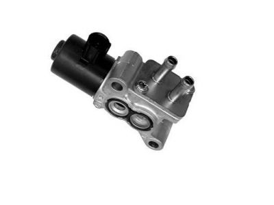

Sorry, you sent the wrong diagram, that is the EACV.
I don't have the diagram but IAT is bolted directly on the intake manifold and is a small piece with only 1 attaching screw. The IAT body socket should white in color.
It would look like a thermistor.
