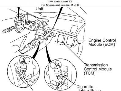

When u take off in reverse then try to go into forward gears it looses gears and wont go like it kicked its self into neatural and when u do get it into forward gears it hits about 3 thousand rpms and kicks its self into neatural so the transmission was rebuilt and still does the same thing what would be the problem.

Did you try to retrieve for trouble codes?
During the rebuild, was any faults found?

No faults were found during the rebuild everything was done right thats why i was wondering if it was the shifting solenoid

If that is the case, the Transmisison control module would be more likely to cause it.

Okay what would the control module be

Tha TCM is the computer for transmission control and is located next to the ECM ( engine computer ) under the foot rest of the passenger.
https://images.2carpros.com/forum/automotive_pictures/192750_ECMLocation94Accord_1.jpg
