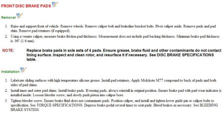

how to change the brake pads?
Oct 11, 2008 at 8:03 PM
MHPAUTOS
Experienced Mechanic
31,937 POSTS
Hi there, Front pad change as per text. Mark (mhpautos)
