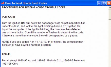

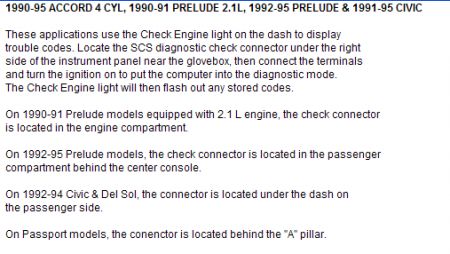

my engine light started blinking yesterday and its riding really rough like its trash in the fuel line. what should or what can i do?
Mar 22, 2009 at 4:59 AM
MERLIN2021
  • 17,250 POSTS
Read the codes! Light blinks when damage to the converter is happening, or possible.
https://images.2carpros.com/forum/automotive_pictures/62217_honda_2.jpg
https://images.2carpros.com/forum/automotive_pictures/62217_hondb_1.jpg
https://images.2carpros.com/forum/automotive_pictures/62217_hondc_1.jpg
Post results...I can then look up the codes for you.
