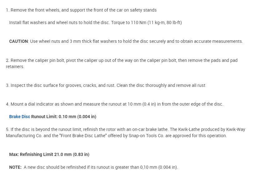

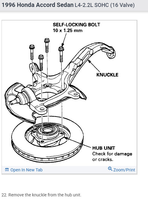

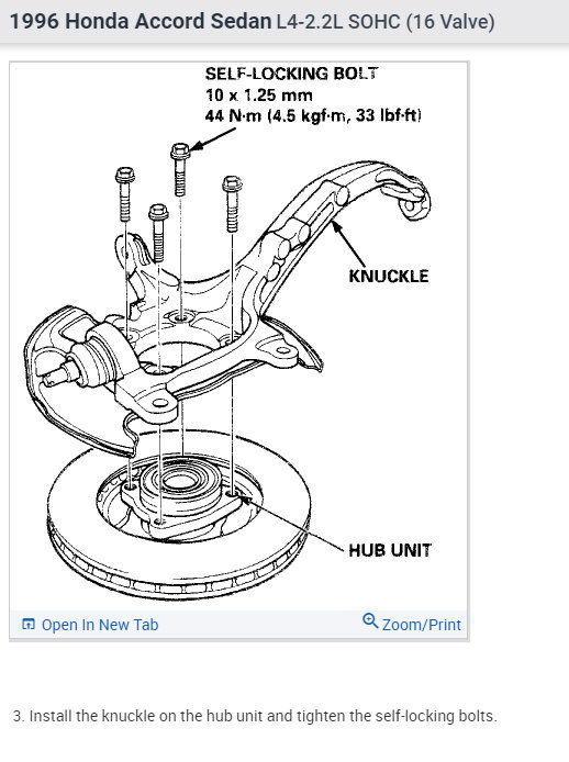

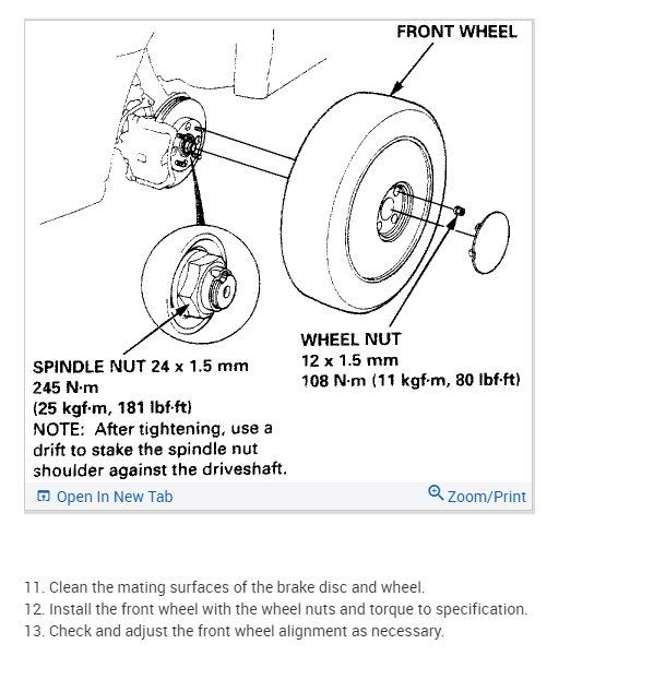

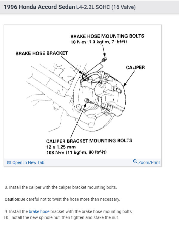

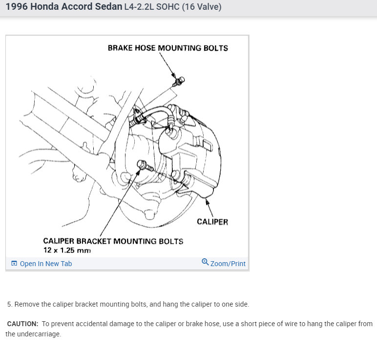

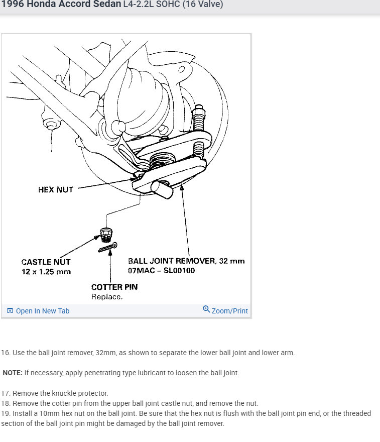

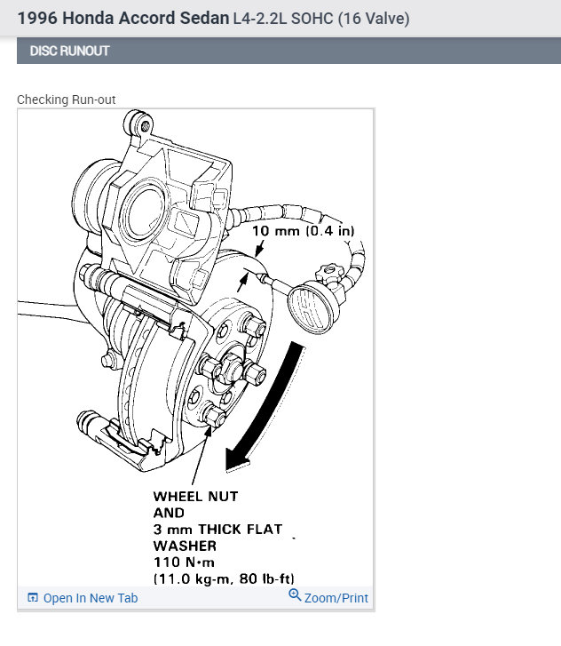

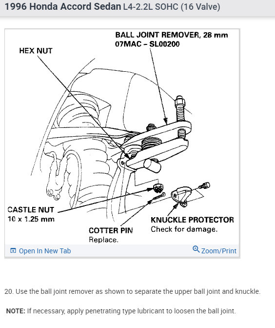

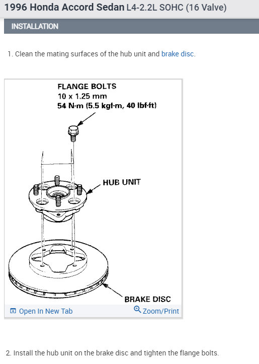

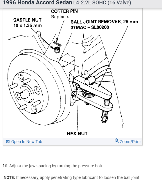

How do I take off the rotors from the front of the car they seem to be stuck and will not come off
Wednesday, September 3rd, 2008 AT 10:58 AM
SQM
  • 6,383 POSTS

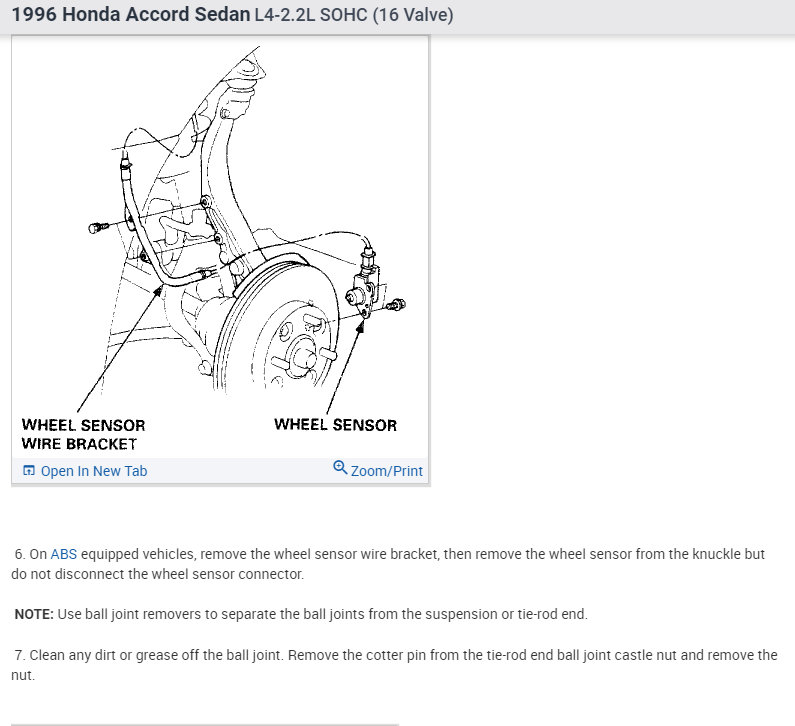

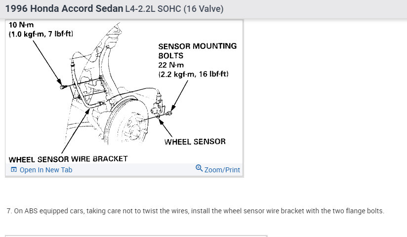

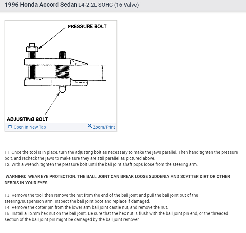

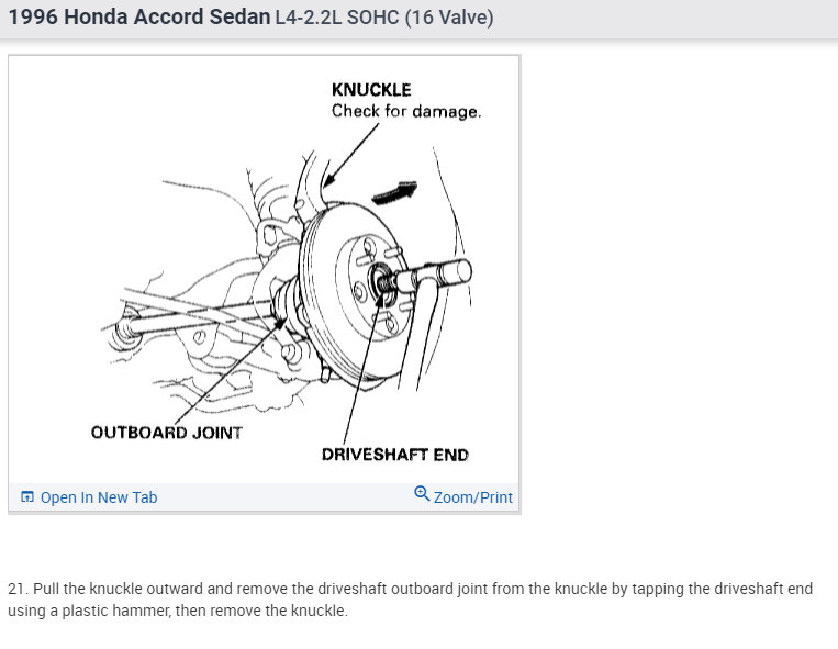

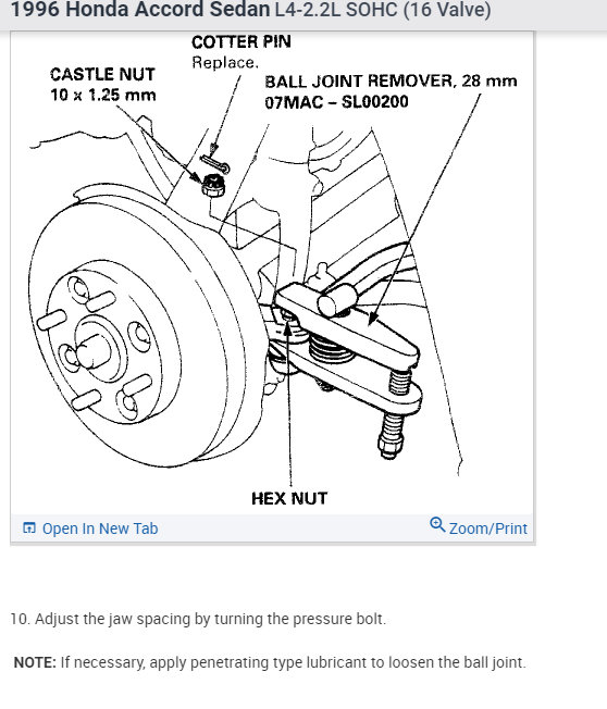

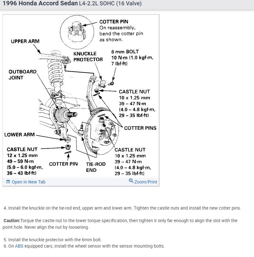

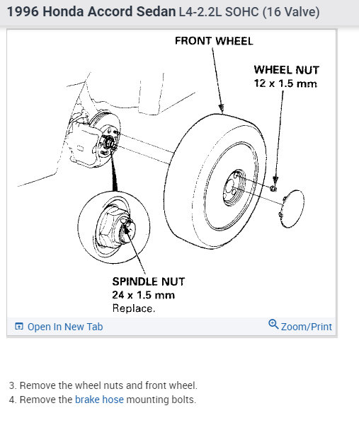

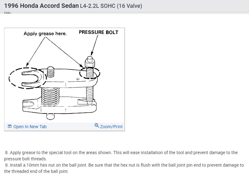

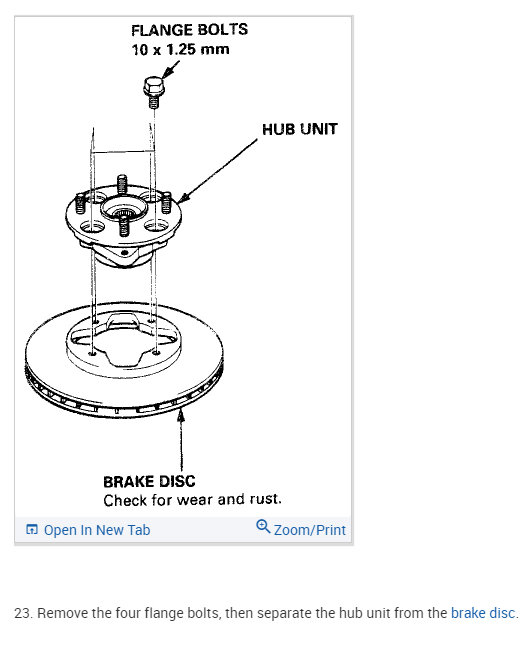

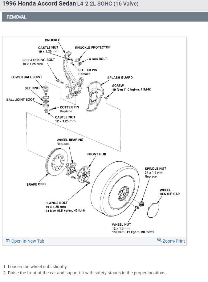

On this vehicle, in order to replace the rotor, the knuckle needs to come off first, then the rotor can be removed from it.
This one takes little longer than a typical front wheel drive vehicle rotor replacement.
I have attached the replacement procedure below with all the diagrams.
