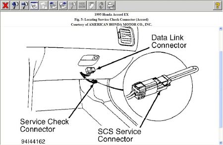

I have an early 1995 Accord 4 cyl. with a check engine light on. Where is the connector on the car and want 2 pins do I jump to count the number of light flashes. (long and short)

Hi dennismant, Check out the diagrams (Below). Please let us know if you need anything else to get the problem fixed.
https://images.2carpros.com/forum/automotive_pictures/192750_SCS95Accord_1.jpg
