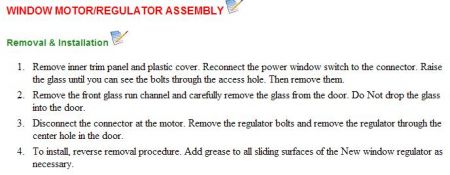

How do i remove and replace a window regulator

https://images.2carpros.com/forum/automotive_pictures/261618_Noname_1236.jpg
Dec 5, 2009 at 10:51 PM
