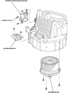

I have a problem with my '94 Accord. When I turn the AC on low it is no problem, but when I turn it up high, there is a very high-pitched annoying sound from inside the cabin (I think). Is this the blower motor? If I should replace it, where is it and how do I find it?

Could be rubbing against its housing

BLOWER MOTOR REPLACEMENT
The blower motor, recirculation control motor and blower resistor can be replaced without removing the blower unit. Disconnect the connector from the blower motor, remove three mounting screws, remove blower motor. Reverse steps to install.
