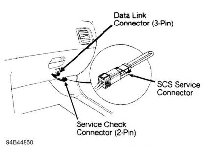

how do i chexck the flash codes on my accord can i cross the plug under the dash. because when I the light does not flash

That is the plug you want to jump.
