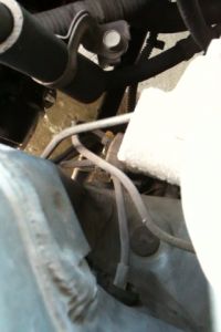

I have a serious problem here. im hoping it isnt as bad as it looks but im no expert.
When the engine gets hot the car overheats. I have replace the thermostat and radiator only to find the coolant leaking really really bad from behind the engine.
THe leak is located about a foot down from the Oil Cap on the backside of the engine on the drivers side. Here is a picture that i took from a video i took from it. Here is the youtube video link as well of the leak. Any Help would be appreciated.
http://www.youtube.com/watch?v=exanAQPCbbo
http://www.2carpros.com/forum/automotive_pictures/523714_IMG_0105_1.jpg
Am i missing some kind of a hose?

Hi emhsdude,
The video did not show very clearly where the leak is coming from. If you get under the vehicle, yu should be able to see where the leak is coming from.
At that area, possible leakagesa are from :
1. Water pump.
2. Water passage leading to water pump from thermostat.
3. Heater bypass hose.
