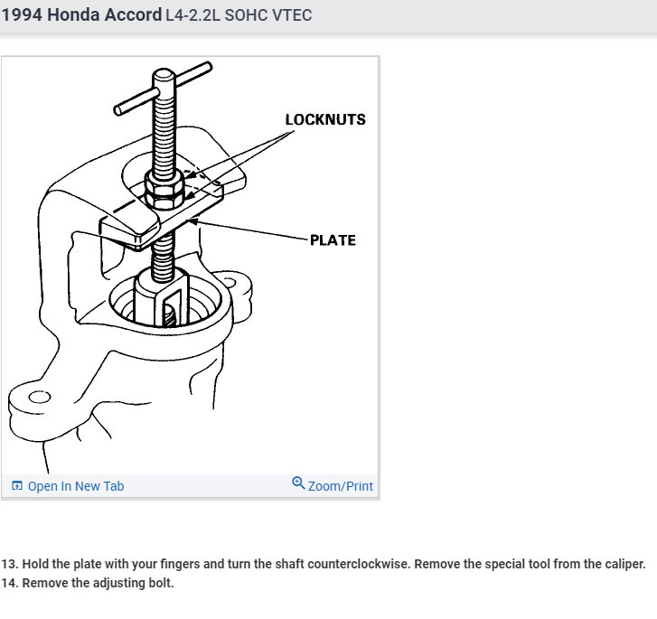

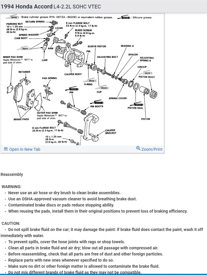

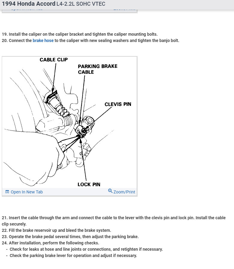

I been trying to replace my rear driver caliper but dont know how to do it
CALY978
  • 1994 HONDA ACCORD
  • 4 CYL
  • FWD
  • 196,000 MILES

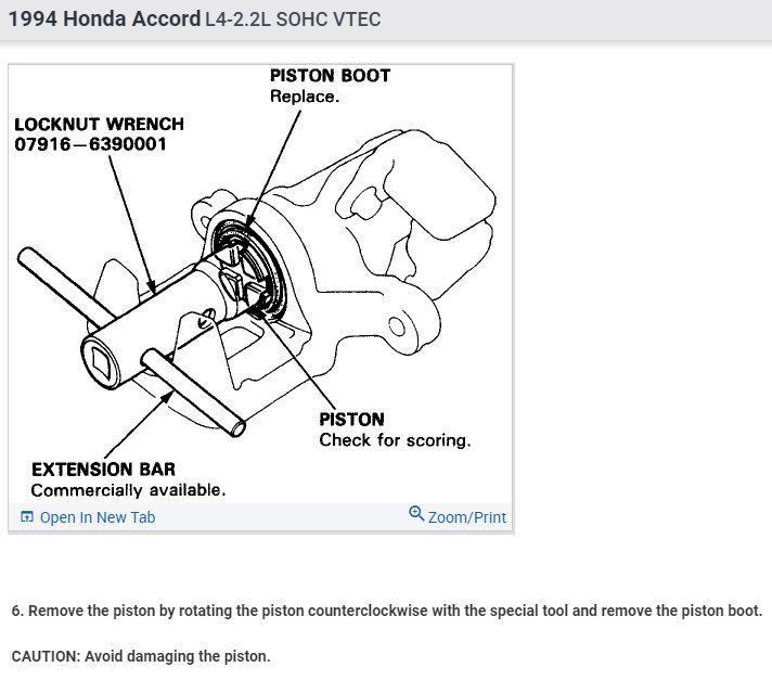

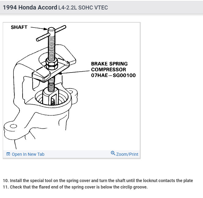

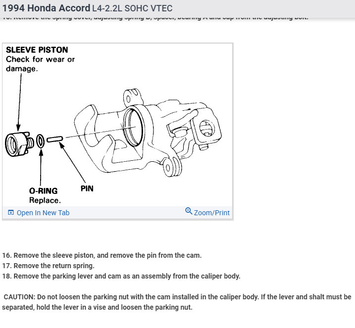

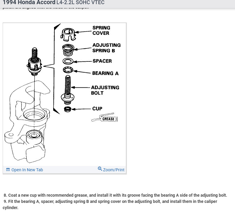

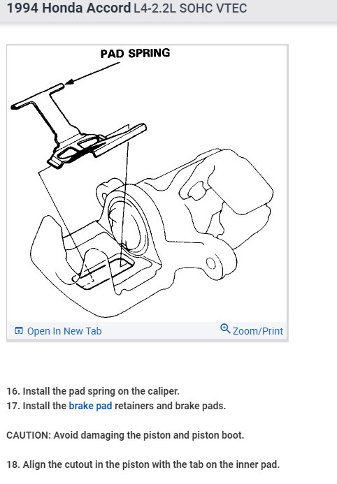

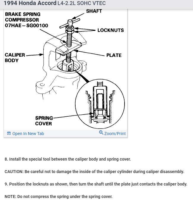

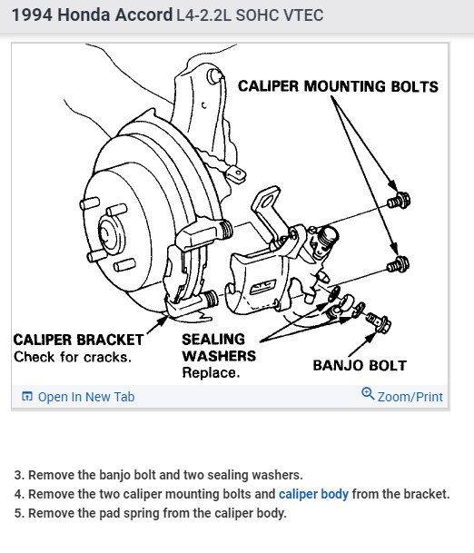

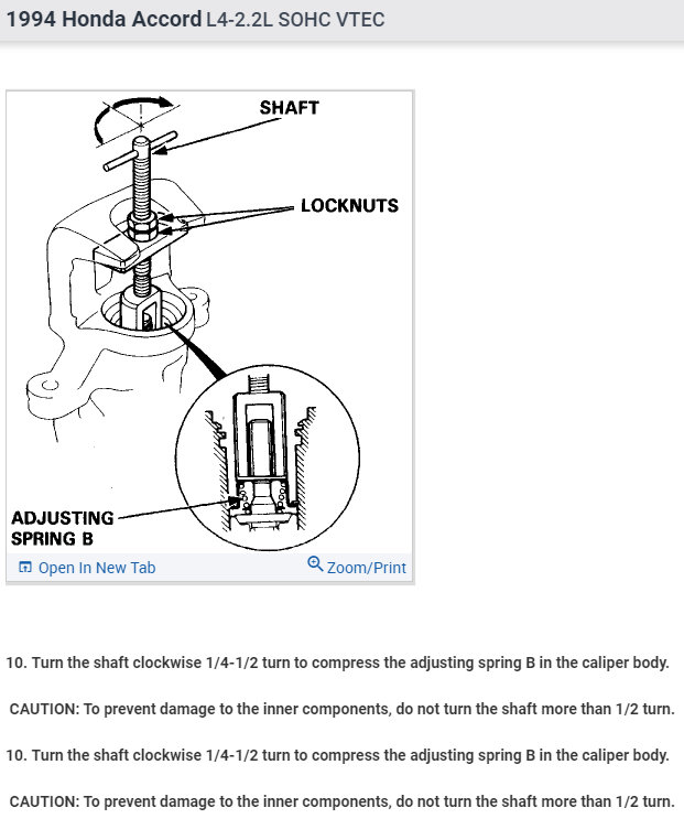

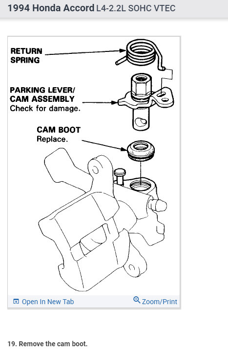

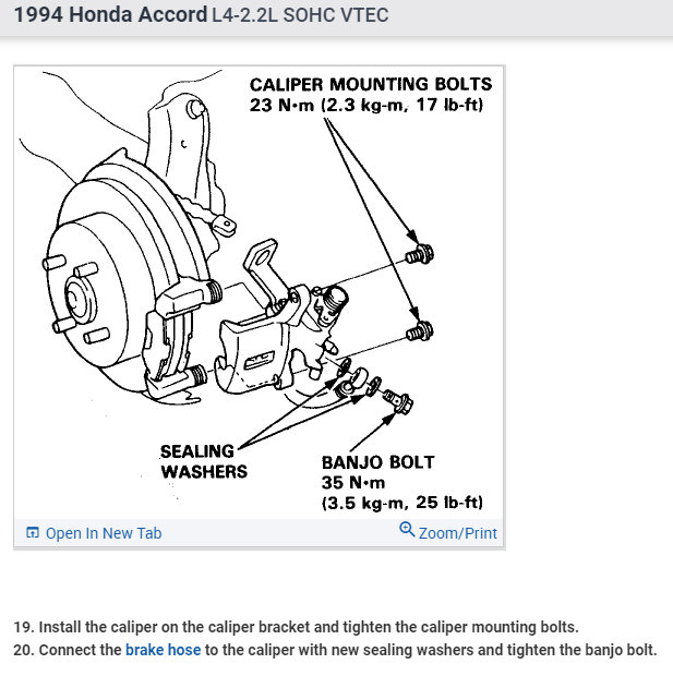

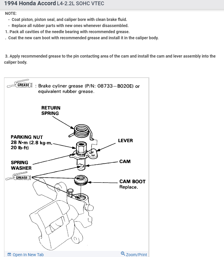

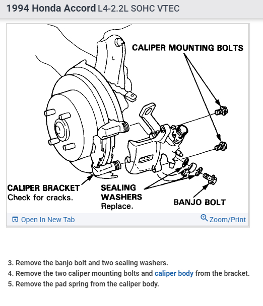

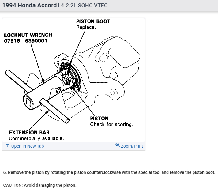

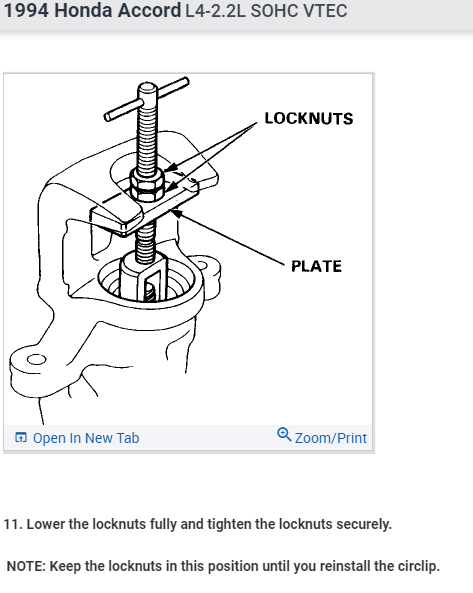

Hi I have a 94 accord ex nd I been trying to replace my rear driver caliper but dont know how to do it, can you help me with that please?
Sunday, September 20th, 2009 AT 9:20 AM
SQM
  • 6,383 POSTS

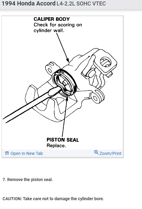

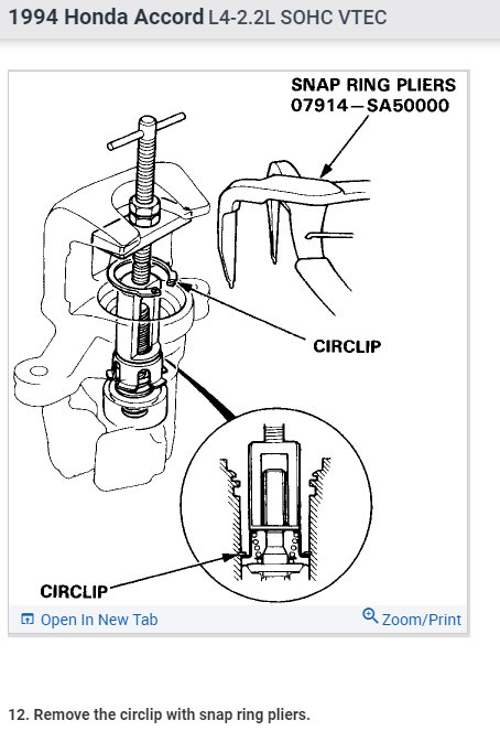

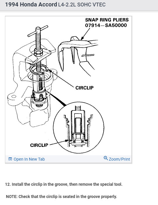

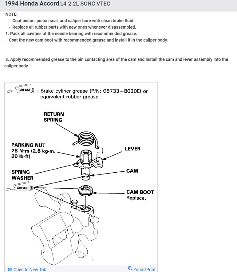

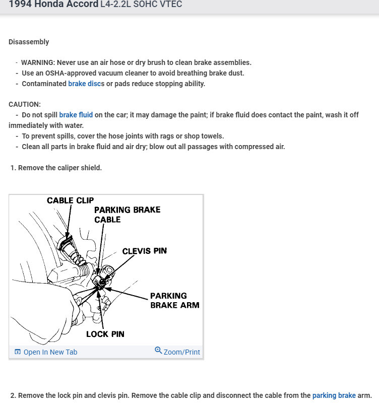

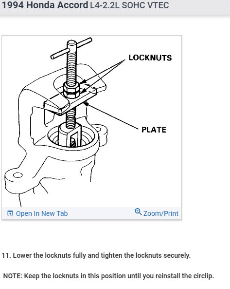

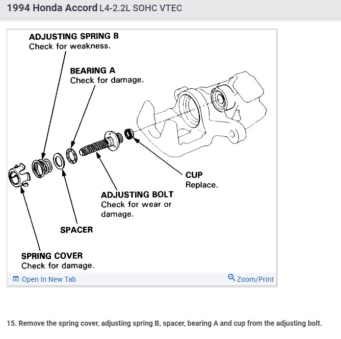

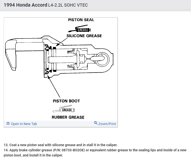

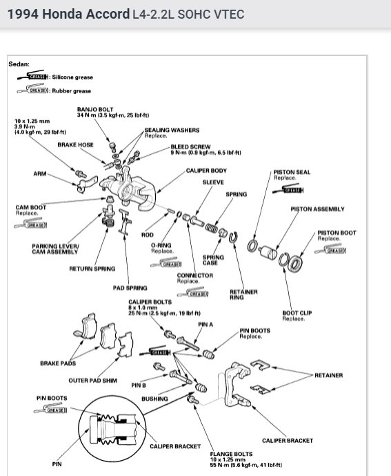

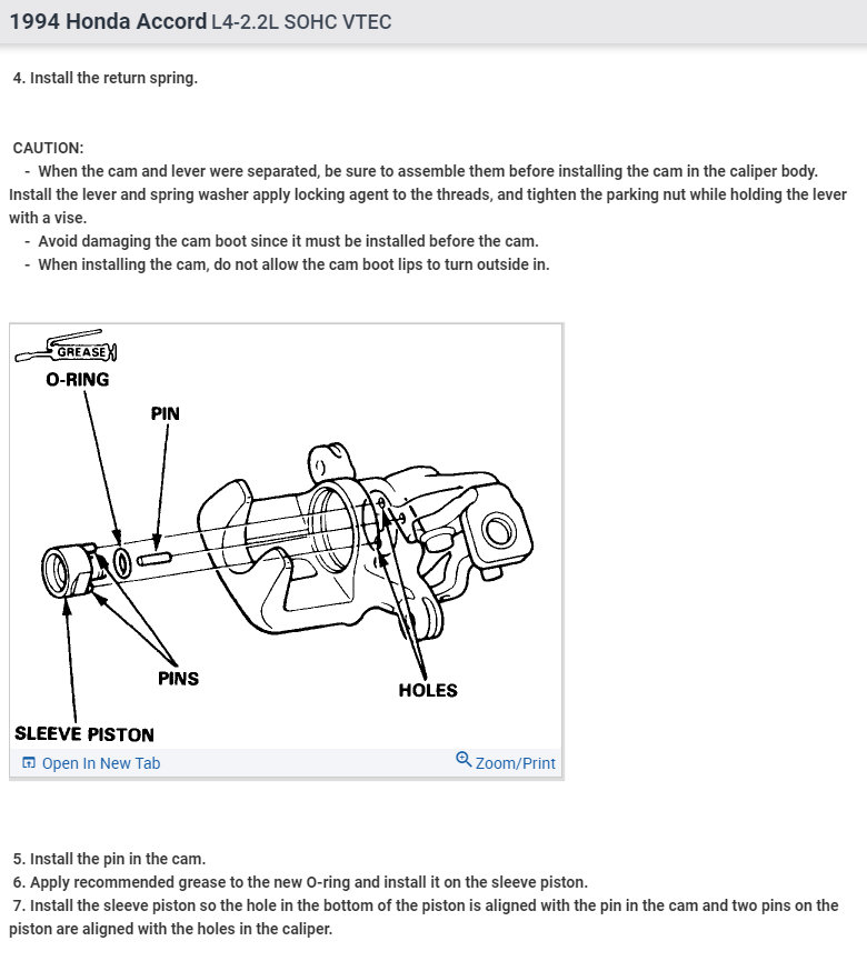

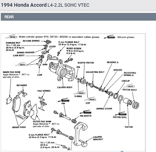

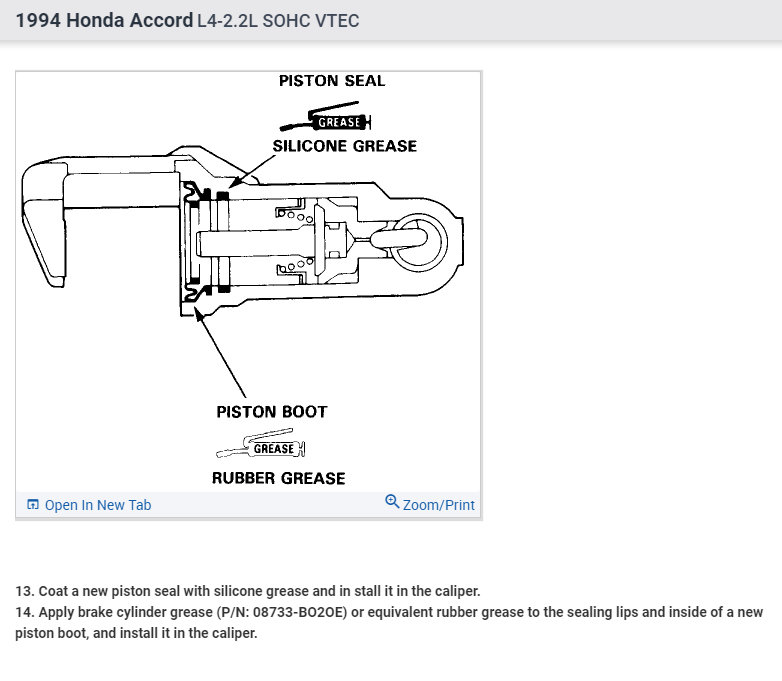

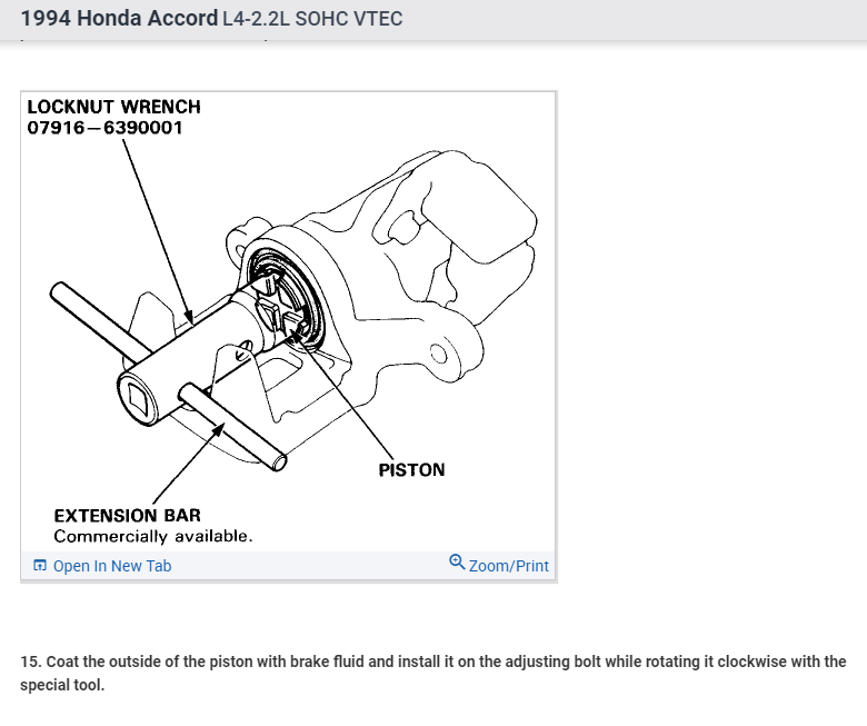

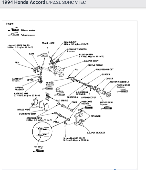

The rear caliper can be replaced using basic hand tools.
https://www.2carpros.com/articles/brake-caliper-replacement
Keep in mind that after replacing the caliper the brake needs to be bled to purge out any air that might have gotten trapped in the brake lines.
https://www.2carpros.com/articles/how-to-bleed-or-flush-a-car-brake-system
I have attached the caliper replacement as well as rebuilding instructions below.
Thursday, October 21st, 2021 AT 2:14 PM
