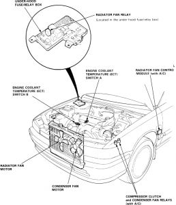

1993 Honda Accord 4 cyl Front Wheel Drive Automatic 223k miles
the car over heats in stop and go traffic, changer the thermostat, still did it, then i noticed the radiator cooling fan doesnt come on, thought i would check the fan moter, can you tell me where it is ?
Aug 13, 2010 at 1:07 PM
  • 75,988 POSTS
Radiator Cooling Fan Motor Component Location
https://images.2carpros.com/forum/automotive_pictures/12900_f1_25.jpg
