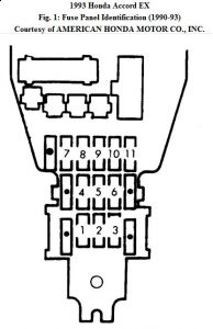

I have a 1993 Honda Accord and the dasboard lights are working but the instrument indicator lights aren`t working.

Hi jones1964,
Check the # 1 guage fuse underdash.

The dash lights are working but the needles on the tach, speedometer, fuel, and temperature gauges aren`t lighting up

You would need to remove the meter cluster to replace the bulbs. There are a few bulbs and some are blown, they share same circuit as dash backlights.
