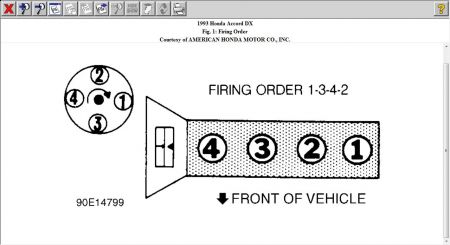

hey what going my name is paul and i have a problem see the thing is that the valve cover gasket didnt work and oil went into the spark plugs they got completly flooded in oil but thats not the problem because i changed the gaskets but know it doesnt want to start "in what order r the cables suppose to be"? and my other ?is could the car had messed up by me driving it like that because i think it was running with two spark plugs?

Hi thisguy80, Welcome to 2carpros and TY for the donation and selecting us as your auto repair site Feel free to ask questions at anytime and Merry Christmas and a Happy New Year 2010 Having oil in that area will cause the plugs to short out and creates dead cylinders-secondary surge voltages coming from the coil is shorting out before it hits the plugs F/O:
https://images.2carpros.com/forum/automotive_pictures/12900_honda_fo_2.jpg
