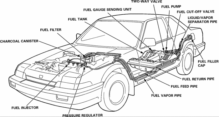

i have a 1993 honda accord 10th anniversary and i want to know where the fuel filter is located.

Hello this guide can help us with diagrams below to help you on your car. https://www.2carpros.com/articles/how-to-change-a-fuel-filter

The fuel filter is up in the engine compartment. Here is a guide and a diagram below to help you get the job done.

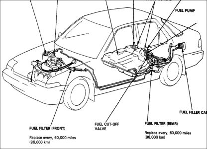

where is the primary fuel filter? thank-you

Hello - I have attached a pic where the filters are.
https://images.2carpros.com/forum/automotive_pictures/248015_Fuel_Filter_2.jpg

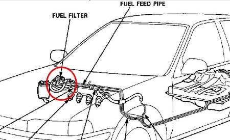

STEVIEH
1997 Honda Accord Special Edition, 153000 miles. I need to ask two questions, please. Where is the fuel filter on this car? Also, replacing the valve cover gasket, spark plugs and wires, there are 4 o-rings in the gasket kit. Where do these o-rings go? Thanks for your help.

The fuel filter should be on the firewall. Follow the fuel lines coming off the injector rail.

the fuel filter on that model is either under the vehicle near the subframe just below the driver's floor(on the incline and a little tough to see sometimes) the other place is (can't remember exactly what year they started doing this) in the fuel tank which you only service IF you have a fuel pressure problem(basically its just a screen on the end of the pump)
