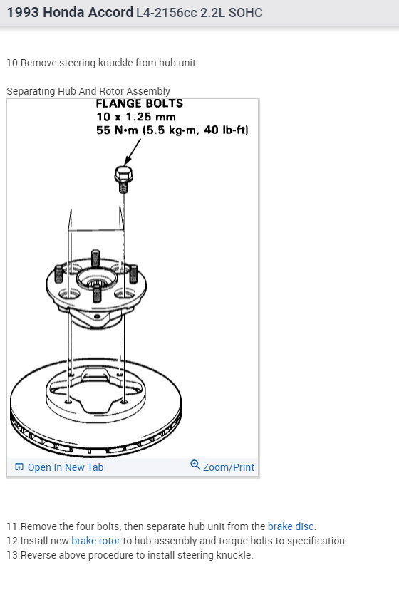

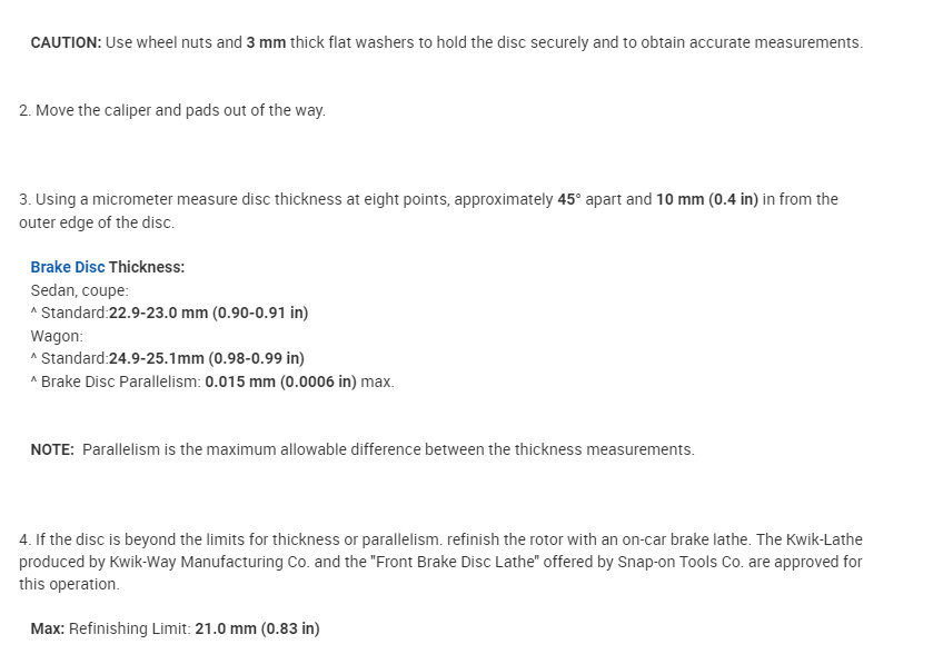

I can not get the rotors off the accord. They aren't like the civic they are inbetween. What do you suggest?
Saturday, October 4th, 2008 AT 9:37 PM
SQM
  • 6,383 POSTS

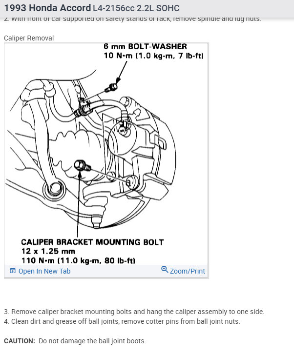

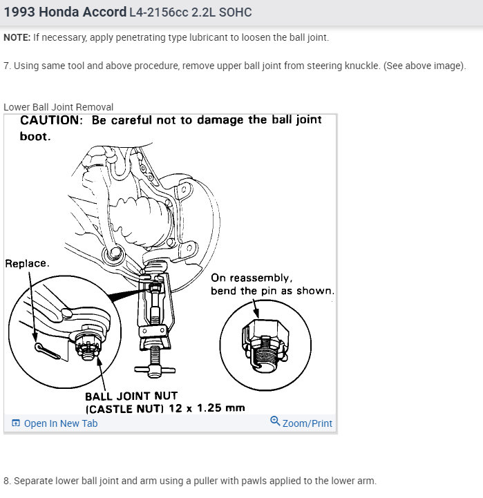

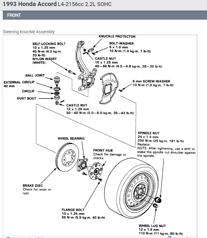

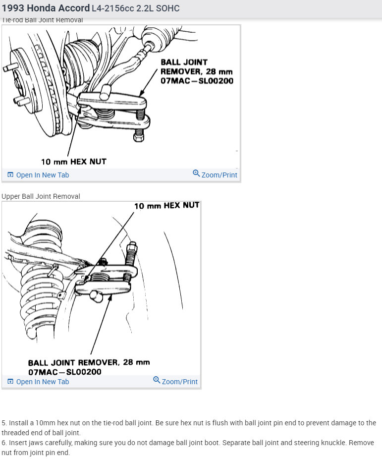

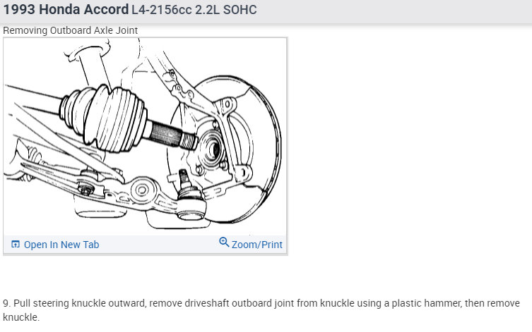

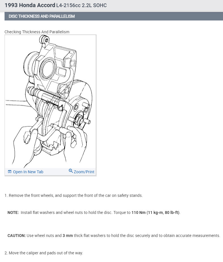

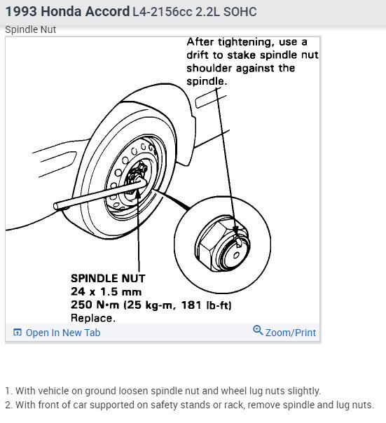

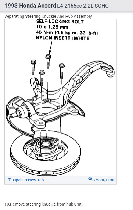

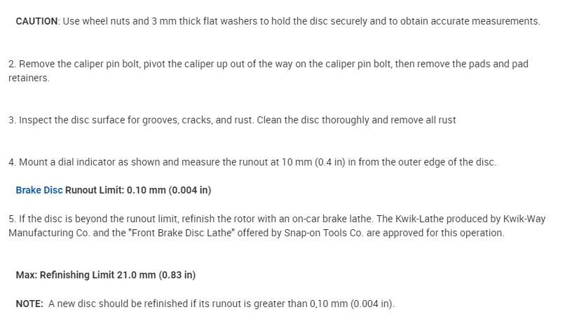

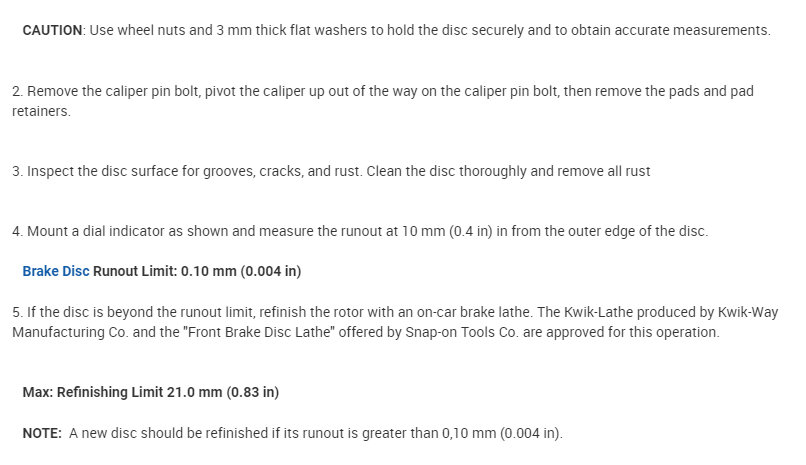

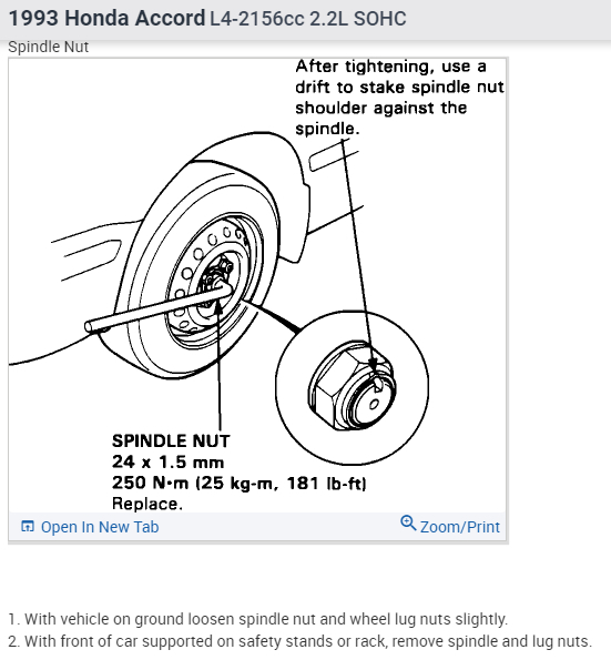

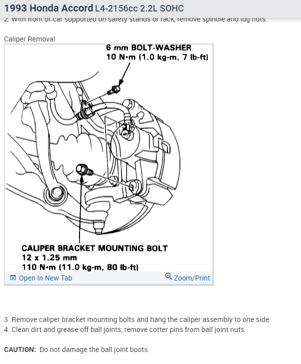

In order to replace the rotor on this vehicle, you will have to remove the knuckle.
So, first step after taking off the caliper is to remove the knuckle with the rotor mounted on it together.
Then you will be able to remove the rotor from the knuckle.
It does take little more time compared to a typical front wheel drive vehicle rotor change.
I have attached the replacement instructions below.
