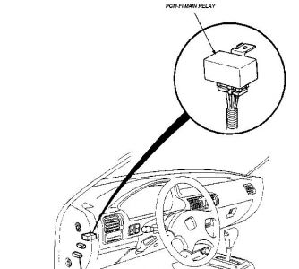

Ok, I have a 1993 Honda Accord EX 2.2L L4 with approx. 150k miles on it, we have had the car for less than a year with absolutely no problems, the car was recently smogged and passed with flying colors, just prior to the smog I gave it a major tune up, plugs, wires, rotor, dist cap, checked timing, fuel filter, new battery, electrical test at all sensors, k&n air filter, oil and oil filter. All was well until last week, I pulled the battery for test in another honda and after I replaced it, it started with no problem and after 3 or 4 minutes the engine started to sputter, tach between 300 rpms and 800 rpms, idled rough, then died. on attempt to restart, would not start. Let sit 10-15 minutes, starts then repeats, now thats all i get out of it is 5 minutes at most. What could it be, a little research points to all sensors and the main relay or the ECM? Thanks!

Hi warrant2k2, Thank you for the donation. I would suggest checking the PGM-FI main relay first. Remove it and resolder the circuit board and retest.
https://images.2carpros.com/forum/automotive_pictures/192750_PGMFIRelay93Accord_12.jpg
When the engine fails to start, you should check if it is fuel or ignition sprks that is missing.
