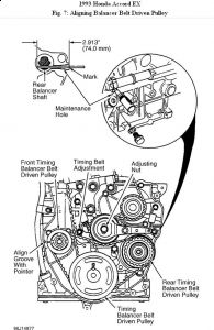

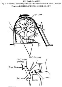

HOW DO I SET THE TIMING? I'M A 25 YR OLD FEMALE THAT HAS CHANGED MY WATER PUMP AND TIMING BELTBUT I DON'T KNOW WHERE THE TIMING MARKER IS. CAN SOMEONE PLEASE HELP ME? :)

Hi BERBIZ,
The diagrams shows the timing marks.
