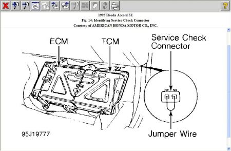

Hi josecar23, When the D4 light is blinking, an error with the transmission has been detected and you need to retireive the Diagnostic Trouble Code (DTC) to find out which component is malfunctioning. Use a jumper to bridge the SCS and turn ignition switch to ON. Count the blinking of the D4 lamp to retrieve the DTC.
https://images.2carpros.com/forum/automotive_pictures/192750_SCS93Accord_7.jpg
