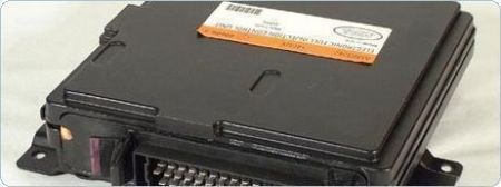

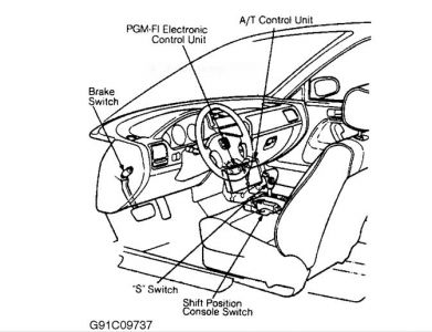

My question is can you tell me what the TCM looks like or perhaps provide a picture? And where is it located on the car? Don't worry about everything else i guess I was mostly venting.

Hi there, Thank you for the donation, See pic 1 for the location and Pic 2 is a general indication of what a control ECU looks like, they are all much the same in design. Mark (mhpautos)

Did you get this resolved yet? I had almost exactly the same symptoms in my '92 automatic. The D3 or D4 light was on in every drive range; the car wanted to start out in 3rd gear all of the time. Would never shift down into lower gears, except manually. I think it would never shift into 4th either, I forget. Anyways, I had gotten water in behind the dash and it ran down and shorted out some components in the TCM module, which is located right under the carpet under the front passesnger's feet. I could see the component parts that were burnt in my module. The local junkyard wanted $100.00 for a second hand one. I plugged it in, puit it back together and my car ran great, exactly like it was supposed to.
