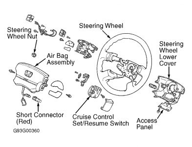

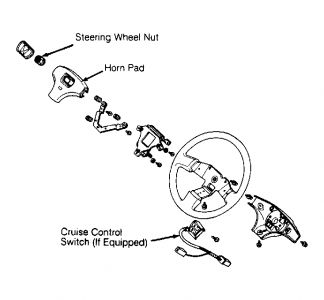

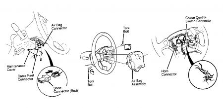

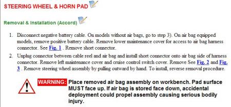

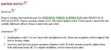

1992 HONDA ACCORD
Steering problem
1992 Honda Accord 4 cyl Two Wheel Drive Automatic
IS IT HARD TO CHANGE
Tuesday, February 16th, 2010 AT 1:36 PM
BLUELIGHTNIN6
MECHANIC
16,542 POSTS
FIG. 1
FIG. 2
FIG. 3
Tuesday, February 16th, 2010 AT 5:20 PM
