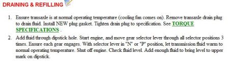

1992 Honda Accord how to change the transmission fluid
KENTREL_W
Transmission problem
1992 Honda Accord 4 cyl Two Wheel Drive Automatic
Sep 22, 2009 at 5:41 AM
F4I_GUY
  • 3,302 POSTS
https://images.2carpros.com/forum/automotive_pictures/276698_honda_AT_1.jpg
Sep 22, 2009 at 11:53 AM
