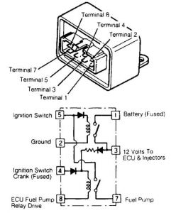

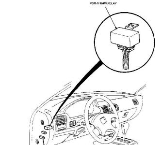

yes my name is tim and im currently having car troulbes...lets say my car starts one week and then next thing you know it won't start and its turning over but not cranking and also when im driving my car everytime its starts slowing down and puttering any help PLEASE! WHAT COULD BE THE PROBLEM AND ESTIMATED COST

Hi Tim, If it is fuel related, the most likely cause would be the PGM-FI main relay. Remove it and resolder the circuit board and it should be good to go.
