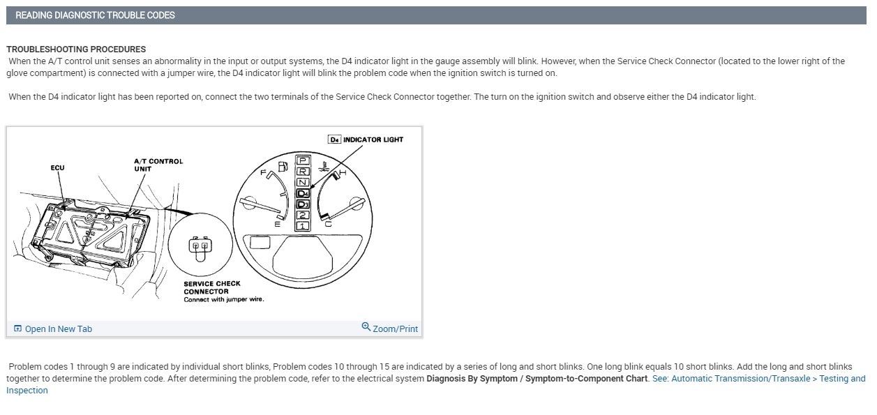

Hi Lillian0625,
The D4 light also acts as an error warning indicator.
Since the light is on, you need to extract the error code to know what has gone wrong.
See the guide below on how to use a voltmeter:
See diagrams below for instructions on code retrieval.
let us know if you need anything else.

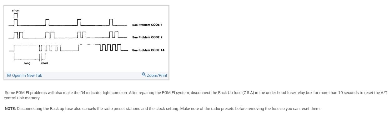

You read transmission codes same as CEL codes through diagnostic connector. The d4 light flashes codes.

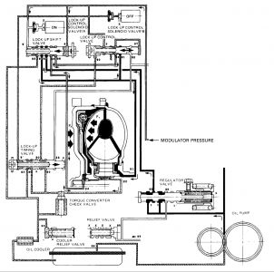

Get code 2 and code 15 on D4 light, shifts erratic at times. Thanks

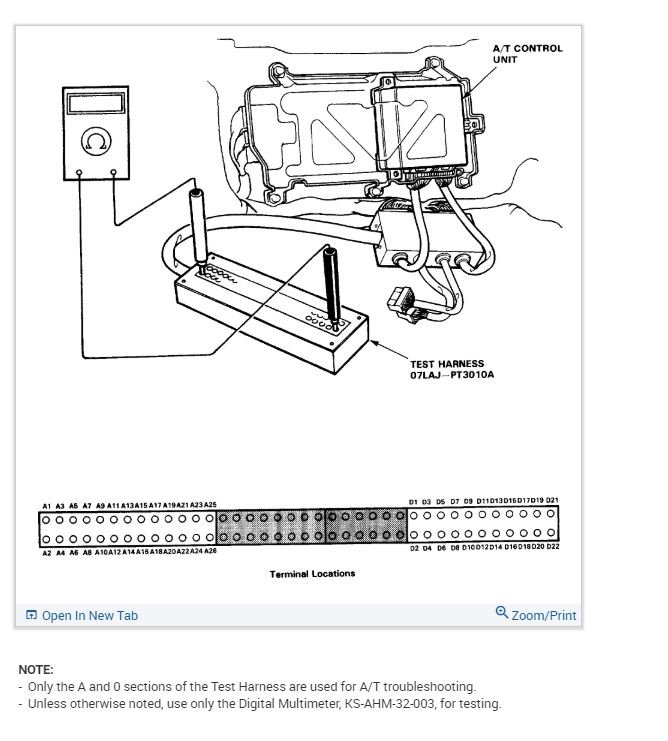

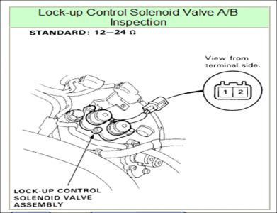

I have attached info on the two codes. Code 2 is for the lock up control solenoid B. I have attached information on check out of both A and B and how to change.
https://www.2carpros.com/forum/automotive_pictures/248015_Code_2_1.jpg
Test For Lock Up Control Solenoid A & B
https://www.2carpros.com/forum/automotive_pictures/248015_97488827_1.jpg
NOTE: Lock-up control solenoid valves A and B must be removed/replaced as an assembly.
Disconnect the connector from the lock-up control solenoid valve A/B.
https://www.2carpros.com/forum/automotive_pictures/248015_Picture16_2.jpg
Measure the resistance between the No.1 terminal (solenoid valve A) of the lock-up control solenoid valve connector and body ground, and between the No. 2 terminal (solenoid valve B) and body ground.
Replace the lock-up control solenoid valve assembly if the resistance is out of specification.
If the resistance is within the standard, connect the No. 1 terminal of the lock-up control solenoid valve connector to the battery positive terminal. A clicking sound should be heard. Connect the No. 2 terminal to the battery positive terminal. A clicking sound should be heard. Replace the lock-up control solenoid valve assembly if no clicking sound is heard.

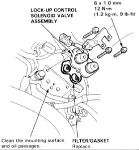

Service and Repair
Notes
Remove the mounting bolts and lock-up control solenoid valve assembly.
NOTE: Be sure to remove or replace the lock-up control solenoid valves A and B as an assembly.
https://www.2carpros.com/forum/automotive_pictures/248015_RR_for_A_and_B_1.jpg
Check the lock-up control solenoid valve oil passages for dust or dirt and replace as an assembly, if necessary.
Clean the mounting surface and oil passages of the lock-up control solenoid valve assembly and install a new filter/gasket.
Check the connector for rust, dirt or oil and reconnect it securely.

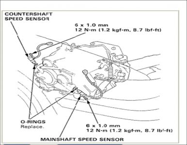

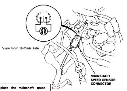

Code 15 is the main shaft speed sensor. I have attached info on how to check that also.
https://www.2carpros.com/forum/automotive_pictures/248015_Code_15_1.jpg
https://www.2carpros.com/forum/automotive_pictures/248015_Code_15_Main_Shaft_Speed_Sensor_1.jpg
https://www.2carpros.com/forum/automotive_pictures/248015_Picture17_3.jpg
Remove the 6 mm bolt from the transmission housing, then remove the mainshaft or countershaft speed sensor.
Replace the O-ring with a new one before reinstalling the mainshaft or countershaft speed sensor.

Found open in wire at speed sensor, replaced sensor, no more code 15. Checked lock up solenoid as per instructions, and checked good, 13 ohms to ground and a good click, and removed and reinstalled. Still have code 2 and d4 light went out, tried another computer from friends wrecking yard, but it did not bring up code 2 or 15 but d4 light will come on. Weird. Other computer out of 1993 Honda automatic.

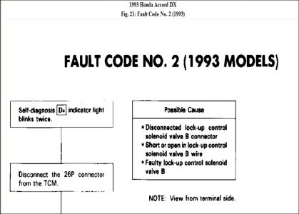

ERNIEBOY
D4 light flashing, solenoids check okay, when driving about four miles or so speed drops to a max of 40 mph and rpm can go to 4,000 or 5,000 and can shift into first, second or third and no difference. I shift into neutral, without stopping and restart the engine and everything okay for next several miles and have to repeat same procedure. The code on the light is 2. What is voltage to solenoids as maybe run a wire to them, to inside vehicle, to my voltmeter, while driving. Thanks
Thursday, September 27th, 2018 AT 8:39 AM (Merged)

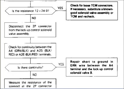

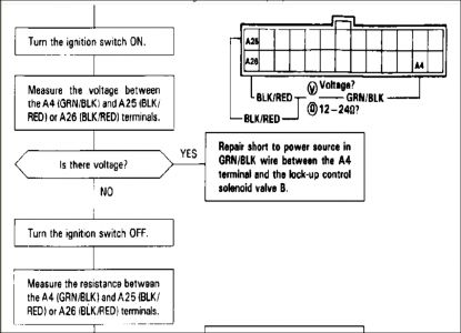

IMPALASS
  • 3,112 POSTS
Hello

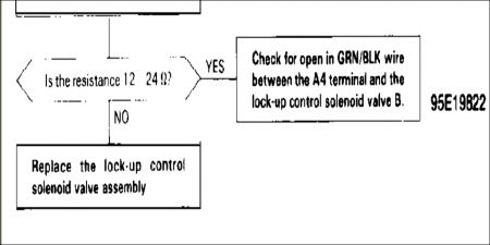

I have attached the troubleshooting tree for code 2.
Also, do you know what gear your transmission is starting out in? There may be an additional chart.
https://www.2carpros.com/forum/automotive_pictures/248015_Trouble_1_1.jpg
https://www.2carpros.com/forum/automotive_pictures/248015_Trouble_2_1.jpg
https://www.2carpros.com/forum/automotive_pictures/248015_Trouble_3_1.jpg
https://www.2carpros.com/forum/automotive_pictures/248015_Trouble_4_1.jpg

ERNIEBOY
Replaced computer and that took care of code 2, still getting code 15, even after changing bad mainshaft speed sensor, and very erratic shifting. I put a quart of trans x in and drove 75 miles, then drained tranny and refilled with with dexron v1 and no more shifting problem and no code 15, with 400 miles, since changing fluid. Thanks for your help.
