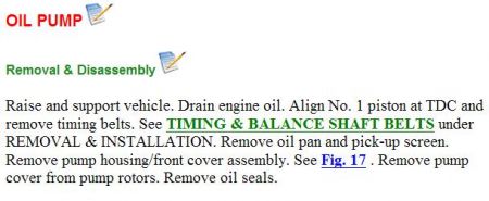

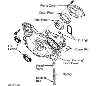

i have a 92 honda accord i am tryin to change oil pump out and would like to no how hard it is and how many bolts are on the oil pump
Dec 3, 2009 at 4:50 PM
MHPAUTOS
  • 31,937 POSTS
Hi there, there is a bit of work involved in doing this, the sump and front engine cover has to be removed as the pump is attached to the in side of the front cover, see pic & text. Mark (mhpautos)
https://images.2carpros.com/forum/automotive_pictures/61395_text_1.jpg
https://images.2carpros.com/forum/automotive_pictures/61395_pic_1.jpg
