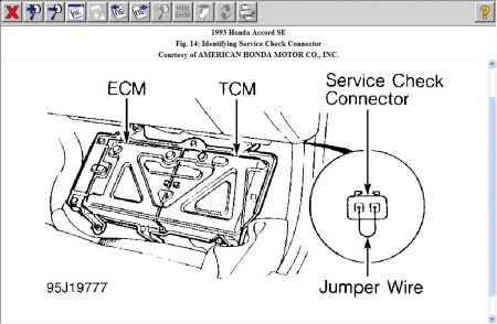

This seem to indicate a faulty TCM also known as ATCU.
Try the folloowing to see if you can retrieve any trouble codes.
ATCU System Fault Codes
1 . With ignition off, connect jumper wire between service check connector terminals. Service check connector is Blue and located at lower right corner of glove box, near kick panel.
https://www.2carpros.com/forum/automotive_pictures/192750_SCS93Accord_13.jpg
This will place ATCU in self-diagnostic mode.
2 . Turn ignition on. Fault codes will be indicated by
blinking self -diagnostic "D4" indicator light on instrument panel.
3 . Fault codes will be indicated by number of short and long blinks. One long blink equals 10 short blinks. For example, a long blink followed by 4 short blinks indicate Fault Code 14.
4 . Once fault code is obtained, determine probable cause and symptom. Remove jumper wire from service check connector.
Let me know the result.
