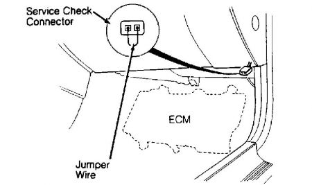

Hi JCARTER763, There is a fault in the system and you need to retrieve the error code for a start.Bridge the wire as shown, turn ignition switch on and count the number of flashes, long for 10 and short for 1.
https://images.2carpros.com/forum/automotive_pictures/192750_SCS91Accord_1.jpg
Sputtering could be due to spark plugs or cables.
