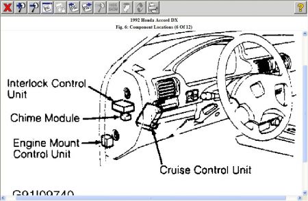

WHERE IS THE CHIME FOR THE HEADLIGHTS, AFTER YOU TURN THE CAR OFF IT MAKES A NOISE LETTING YOU NO YOU LEFT THE LIGHTS ON CAN FIND IT

If it is not working, check if the driver door switch is working properly.
