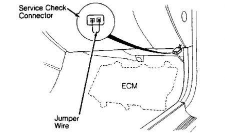

Hi tfranz66, Thank you for the donation. When the S mode lights blinks, an error in the control system has been detected. You can retriee the trouble code but jumpimg the SCS connector and read the blinking of the S light to verify which component caused the problem.
https://images.2carpros.com/forum/automotive_pictures/192750_SCS91Accord_11.jpg
The code is required to understand what went wrong After turning ignition off, the trouble code is temporarily erased from the indicator light and while driving any and problem occurs, the S light would start blinking again. Get the code and let me know what it is. When the S light flashes, the trans control unit would go into limp mode which causes the trans to shift erratically.
