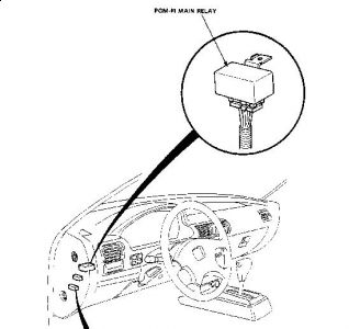

Hi Joelzak,
When the S mode light is blinking while driving, an error has been detected in the transmission control system. However since it is blinking when starting and appears when you are not able to start, the problem should be caused by an intermittently failing PGM-FI main relay.
Remove relay and resolder the crcuit board and you should be good to go.
https://www.2carpros.com/forum/automotive_pictures/192750_PGMFIRelay90Accord_8.jpg
