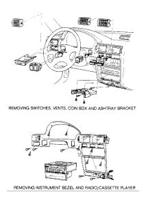

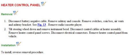

I need to know how to remove the heater blower control switch. I have purchased the switch and do not know how to remove the dash and access the switch.

https://images.2carpros.com/forum/automotive_pictures/261618_Noname_926.jpg
FIG. 13
https://images.2carpros.com/forum/automotive_pictures/261618_Graphic_160.jpg
