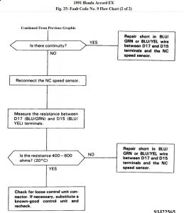

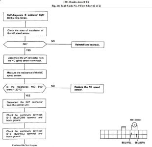

Hello, sometimes my car starts in 2nd gear. Also S light on dashboard flashes while driving. S light code is 9. Can you please inform me how to proceed? Thanks.

Here are the diagnostic procedures.
https://www.2carpros.com/forum/automotive_pictures/192750_Code9Trans91AccordFig24_1.jpg
https://www.2carpros.com/forum/automotive_pictures/192750_Code9Trans91AccordFig25_1.jpg
https://www.2carpros.com/forum/automotive_pictures/192750_TransComp91AccordlFig10_1.jpg

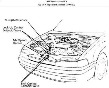

NC sensor is located at rear end of trans. Check if the wires are broken, quite often the counpler gets loose from its locking tab and the wire gets broken by the CV shaft.

Thank you for your help. How can I access NC speed sensor easily? Is it from under the car or from above?
Tuesday, February 2nd, 2010 AT 8:18 PM
KHLOW2008
  • 41,814 POSTS
Sorry for the delay in replying. Seems there is a fault with the notification process.
The sensor can be accessed from top of vehicle. Removing the air intake hose would aloow you to work on it easily.
