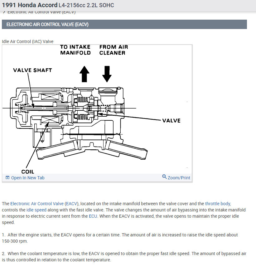

I have a 91 honda accord. When the car is at an idle in gear it acts like it wants to stall. I checked the EGR valve and it checks out fine. I am stumped on what else to check?
Monday, August 4th, 2008 AT 11:43 AM
SQM
  • 6,383 POSTS

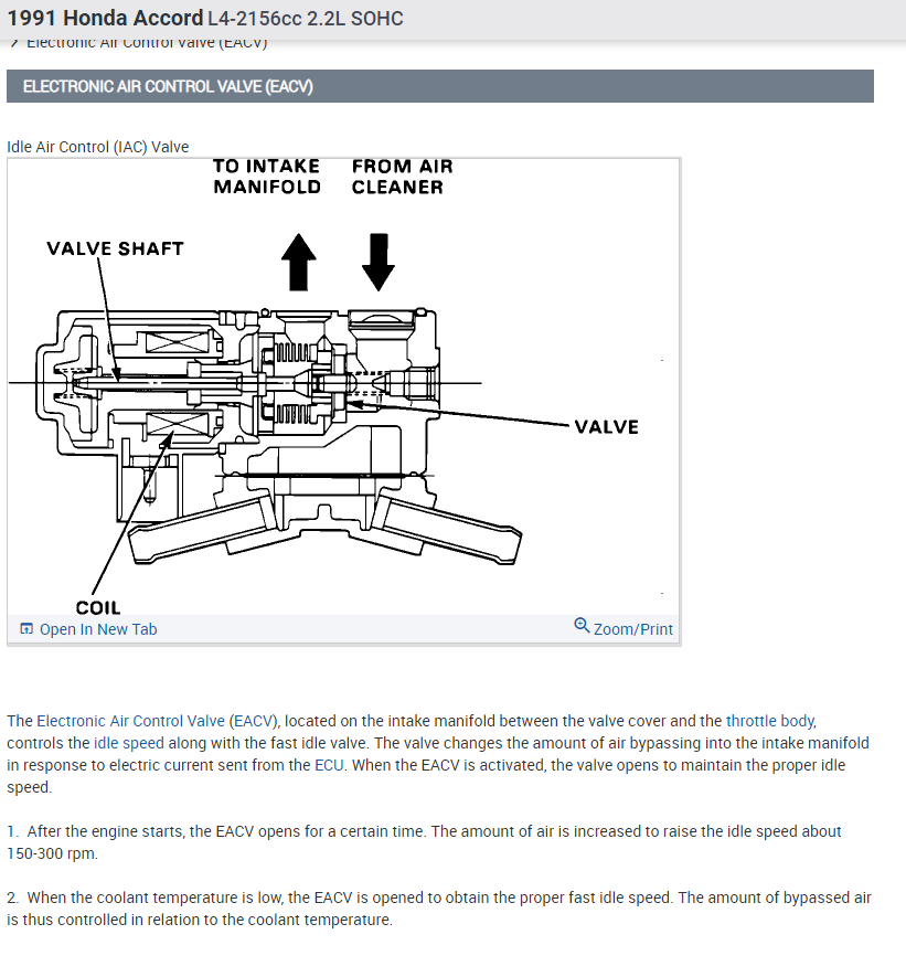

Unless you have already done so, clean your Idle Air Control valve. A dirty IAC can cause the vehicle to have rough idle.
Here is couple of helpful articles:
https://www.2carpros.com/articles/how-a-idle-air-control-valve-works
https://www.2carpros.com/articles/idle-air-control-valve-service

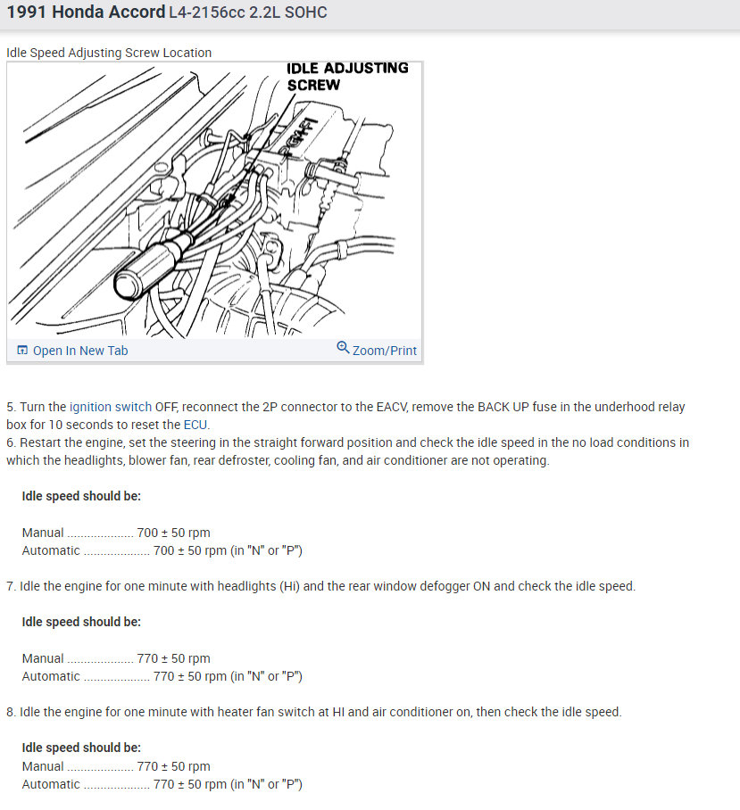

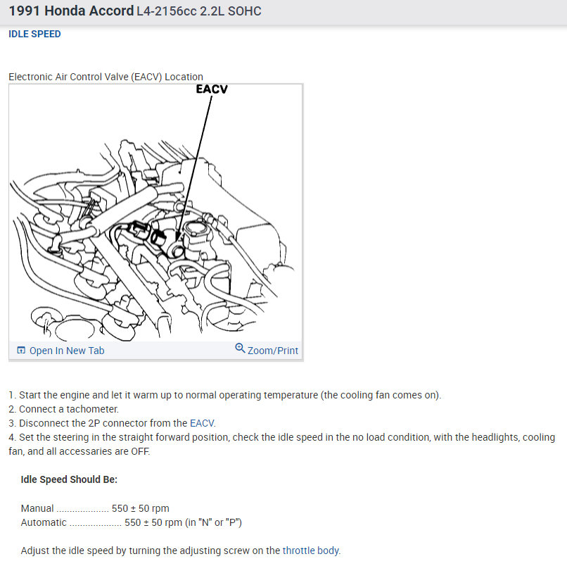

Also on these cars you can adjust the idle speed. I have attached the idle speed adjustment as well as the recommended idle speed for your car.
