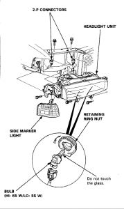

How can I remove the front driver side headlight
LOVEBUG454
  • 1991 HONDA ACCORD
Friday, January 2nd, 2009 AT 7:24 PM

CAUTION: Halogen headlights can become very hot in use, do not touch them or the attaching hardware immediately after they have been turned off. Do not try to replace or clean the headlights with the lights on.
Disconnect the 2-P connectors from the each bulb. Before disconnecting right side connector, remove the battery and the coolant reservoir.
Turn the retaining ring nut to the OPEN position, then remove the bulb.
Remove the screw and the side marker light, then disconnect the 2-P connectors.
Remove the front grille and the front bumper.
https://www.2carpros.com/forum/automotive_pictures/248015_1_143.jpg
Remove the 5 mount bolts, then remove the unit.
After installing the unit, adjust the headlights to local requirements.

how do I remove the front bumper
To remove the front bumper, you need to
1. Remove the front grille.
2. Remove the clips and bolts at bottom of bumper.
3. Remove screws at both end of bumper inside fender.
4. Remove bumper signal lights and fog light assy.
5. Remove bolts inside signal light assy cavity.
6. Remove nut just below the headlight inside ngine compartment.
Removing the battery and coolant reservoir would make access easier.
