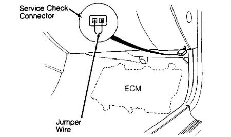

how can i check for damaged wheel sensors or damaged alb pump i need help how to test either wheel sensors or pump

Hi nidal_75, The ABS has a self diagnostic that can teel you what is causing the ALB to malfunction. Connect the SCS and turn ignition switch to ON and count the blinks on the ABS indicator light.
https://images.2carpros.com/forum/automotive_pictures/192750_SCS91Accord_6.jpg
