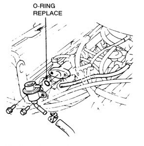

My step-son and his mother got impatient and we took it to the shop, but I'm glad we have this thread going based on the response.
They said "excess fuel pressure" and "blow-by", and that they would have to completely disassemble the engine to determine the problem. Obviously we wouldn't put the money into doing that, but I'm skeptical ...
Correct me if I'm wrong: (1) Isn't fuel pressure regulated by the fuel pressure regulator and replacing the regulator would most likely take care of that? (2) We checked the compression before replacing the valve seals, and it was 180-180-140-180 ... wouldn't we see much worse compression if blow-by was a significant problem?
Thanks,
Dave
Nov 12, 2009 at 4:15 PM
  • CERTIFIED EXPERT
  • 110,176 POSTS
Dave, Yes and Yes. The fuel pressure regulator is attached to the fuel line. Here is a picture of a "rough" location for you and a picture of the regulator.
https://www.2carpros.com/forum/automotive_pictures/249084_reg_2.jpg
https://www.2carpros.com/forum/automotive_pictures/249084_regg_1.jpg
As far as the "blow by," if it is excessive, you can tell by opening the oil cap when the engine is running. If it's excessive, a ton of air will blow out and based on how bad it is, it could actually puff smoke. Also, a plugged PCV valve could cause it to appear as if there is too much blow by. Its purpose is to provide a vent for the crankcase by drawing (vacuum) unburned fumes back into the intake for a second time. Keep in mnd, you have great compression on 3 cylenders and okay on the 4th. Usually, the manufacturers recommend no more than a 10% variation between them, so you have exceeded that. However, that cylender still has more than enough compression to run. At most, I would expect a slightly rough idle. One final thing. Here is a how to for checking fuel pressure. It also includes how to check the fuel pressure regulator to make sure it is working. It contains both written directions and a video. You may want to try checking it yourself. You will need a pressure gauge to do it, but most parts stores will lend or rent that to you. Also, if the regulator is bad, I've seen them for around 60 to 70 dollars. Let me know if you have other questions. Joe
