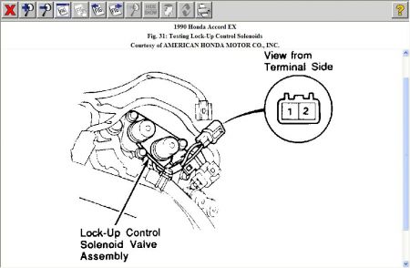

Hi seekerbeat, You have an error code of # 1 = Lock up clutch solenoid valve A # 2 = Lock up clutch solenoid valve B. Check for disconnected wire couplers at solenoid switch or broken wires.
