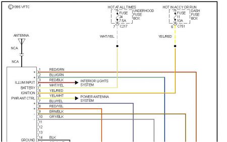

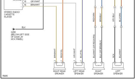

The old radio in the car is still working but the connector to the back of it has a short in it.. I know it is connected to another wire back there but I cant take it out. Could I get a diagram of the wiring harness and what its connected too? Thanks!

Is this what you need?
1990-93 Honda Accord Stereo Wiring
Constant 12V+ White/Yellow
Switched 12V+ Yellow/Red
Ground Black
Illumination Red/Black
Dimmer n/a
Antenna Trigger Yellow/White
Antenna Left Rear
Front Speakers 6 1/2" Doors
Left Front (+) Blue/Green
Left Front (-) Gray/Black
Right Front (+) Red/Green
Right Front (-) Brown/Black
Rear Speakers 6 1/2" Rear Deck
Left Rear (+) Blue/Yellow
Left Rear (-) Gray/White
Right Rear (+) Red/Yellow
Right Rear (-) Brown/White

No I need a diagram of the connector the piece of plastic that connects to the back of the stereo. Its faulty and i need to replace it.
