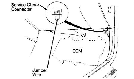

Hi, I just bought a 1990 Honda Accord. The car drives fine, shifts fine, but the "S" light keeps blinking. Can you please tell what is the problem.
Tuesday, November 4th, 2008 AT 4:25 PM
KHLOW2008
MECHANIC
41,814 POSTS
Hi ryanl94,
When the S light blinks, an error has been detected by the TCM and you need to retireve the error code to find out what is wrong.
Connect a jumper wire as shown in picture and turn ignition switch ON. Count the flashes of the S light and post the result here.
Long flashes = 10, short flashes = interger
