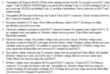

my check engine light comes on when i start my car and back out of the driveway. the computer flashes a code 14 on the top of the computer with a red light. i need to know what that means and how to fix it. thanx

It means a fault with the Electronic Air Control Valve. To check, do the following procedures.
https://images.2carpros.com/forum/automotive_pictures/261618_Noname_6.jpg
https://images.2carpros.com/forum/automotive_pictures/261618_Noname2_1.jpg
