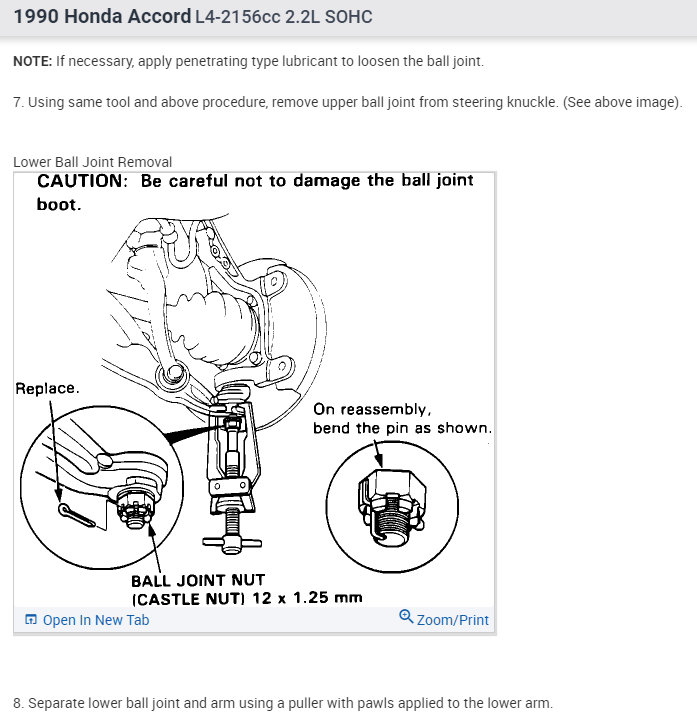

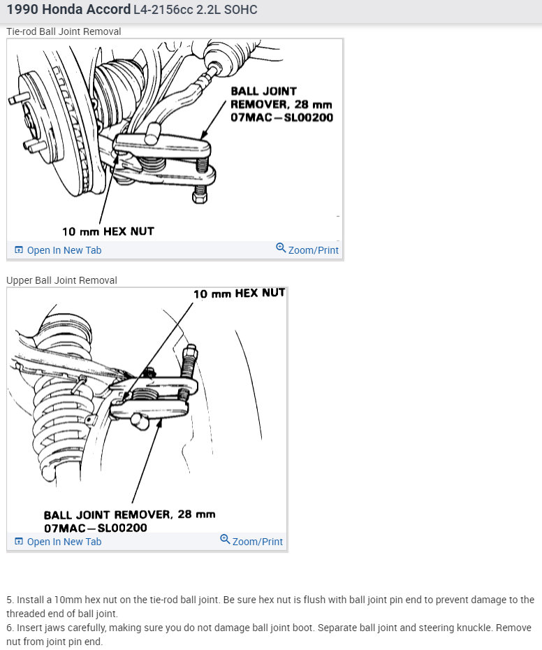

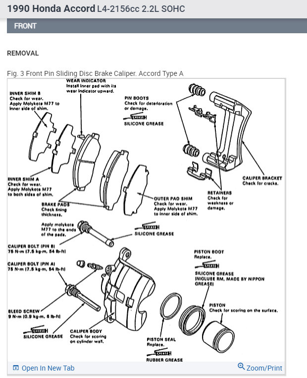

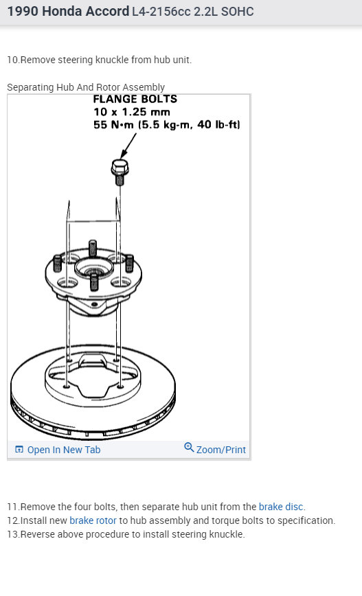

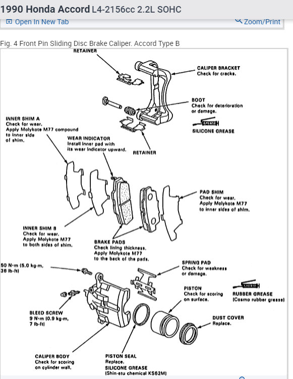

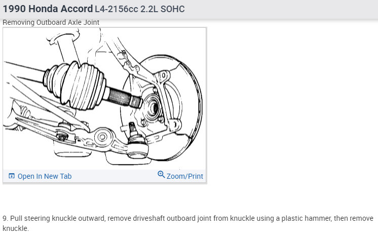

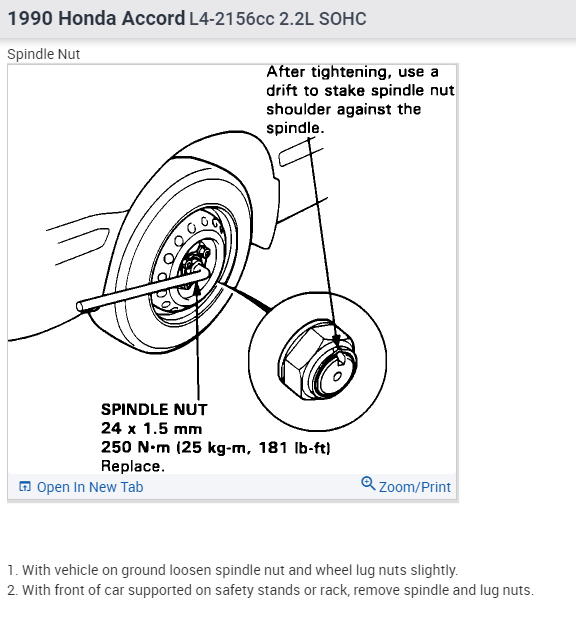

I need info on changing front brake rotors on my 1990 honda accord. Basically need to know if I have to replace any bearings.
Thursday, January 7th, 2010 AT 3:08 PM
SQM
  • 6,383 POSTS

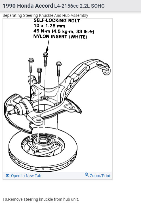

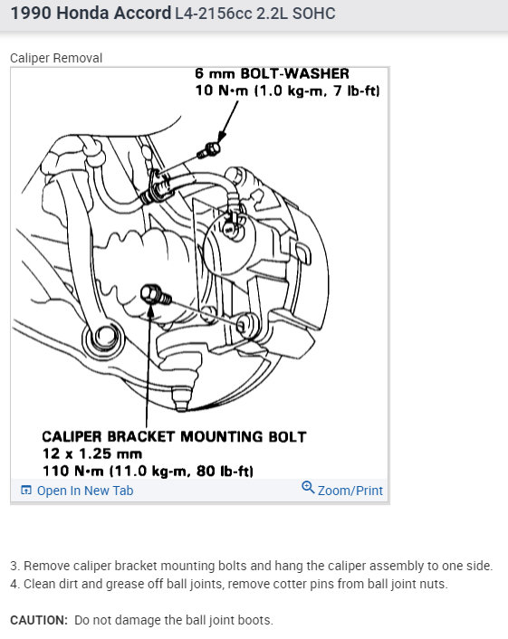

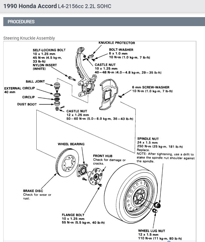

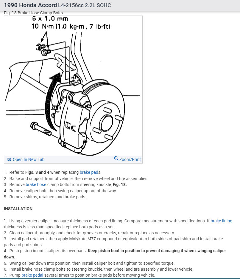

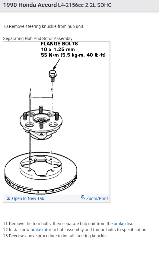

In this vehicle the rotors are setup little differently than a typical front wheel drive car.
In order to replace the rotors, you will have to remove the knuckle and the rotor, then remove the rotor from the knuckle. The bearing bolted to the rotor hub will need to be removed.
I have attached the replacement procedure below.
