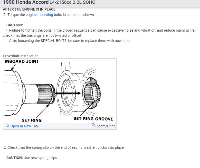

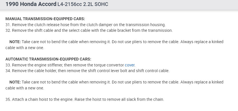

This the thing here. I have an 1990 accord that im going to replace the motor with. I was wandering if the 95 motor will fit into my 90 accord. Also will the 95 engine fit into the 90s tranny? The engine that im getting dont include tranny. Also any other necessary things that is needed to make the 95 fit into the 90? I need help this is my first time.
The engine is f22(both)

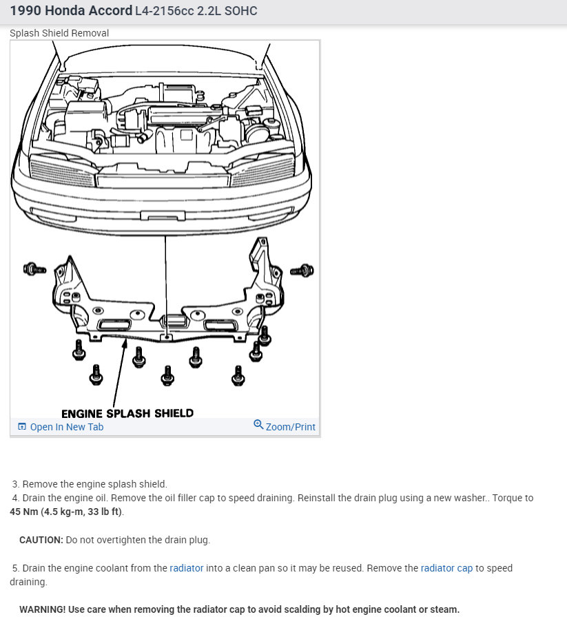

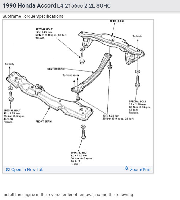

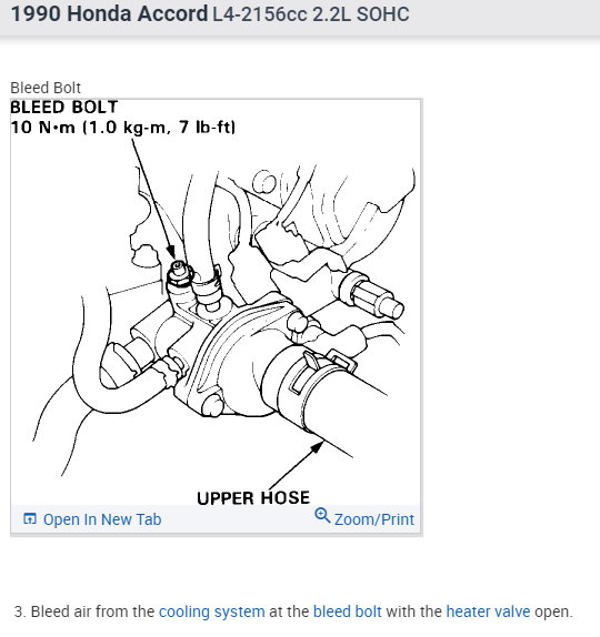

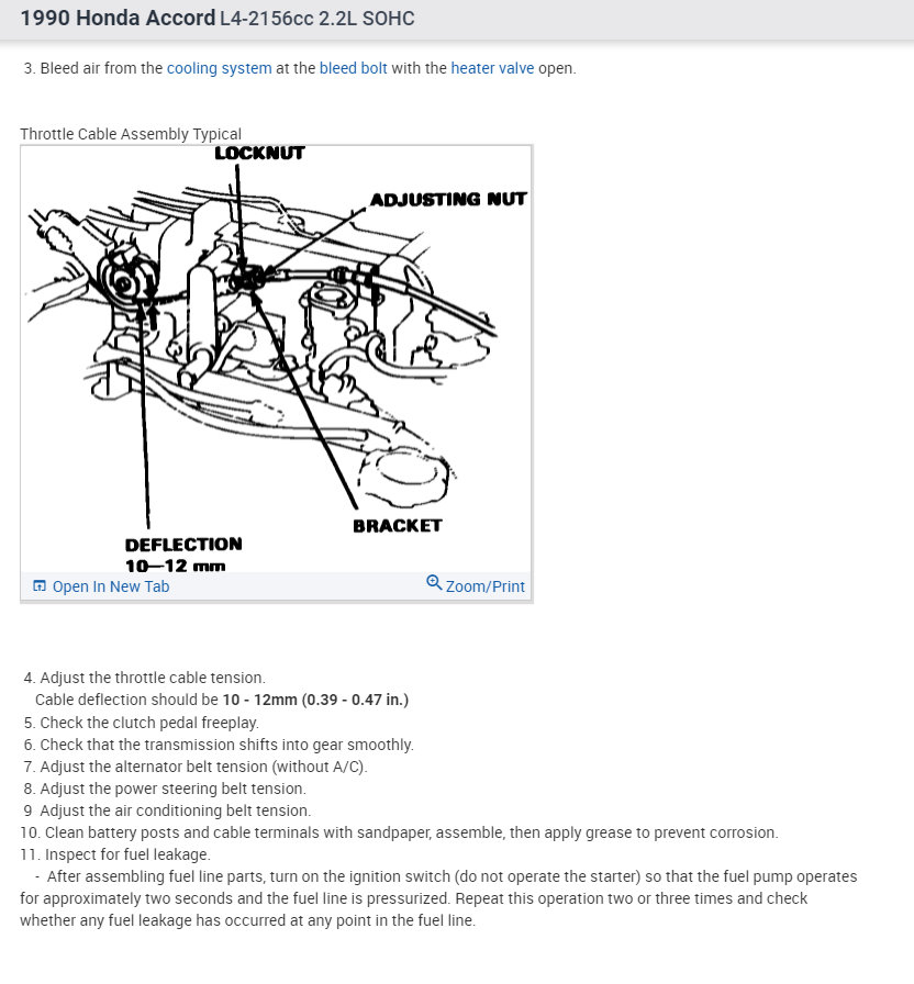

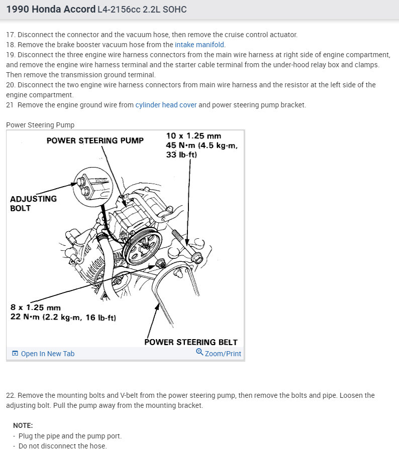

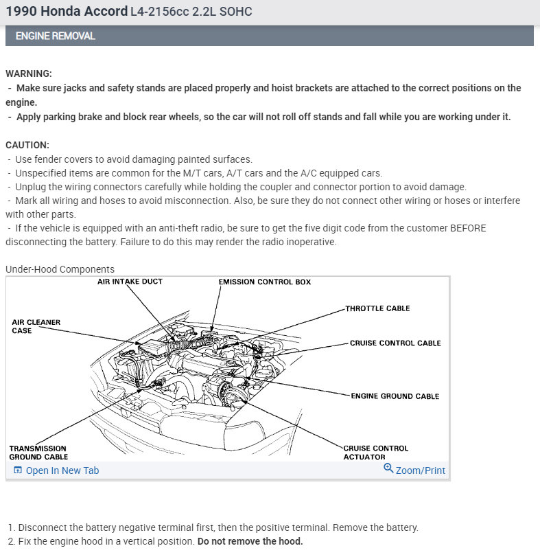

Even though they are the same engine size, each uses different computers and modules.
Only viable option would be to get all the components form the donor can including the engine, transmission and all the computers, in order for this install to work.

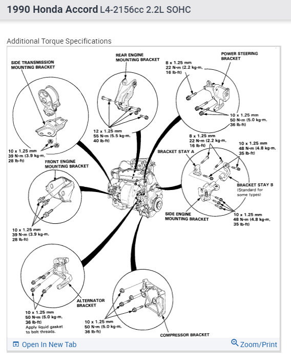

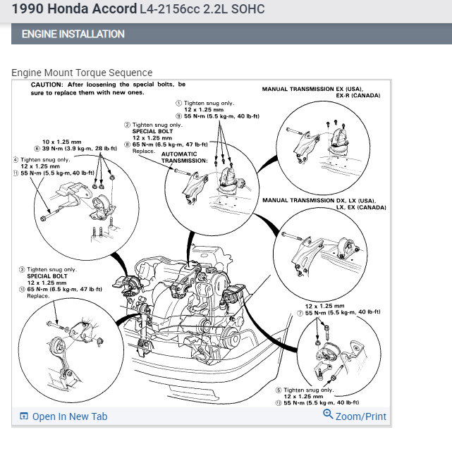

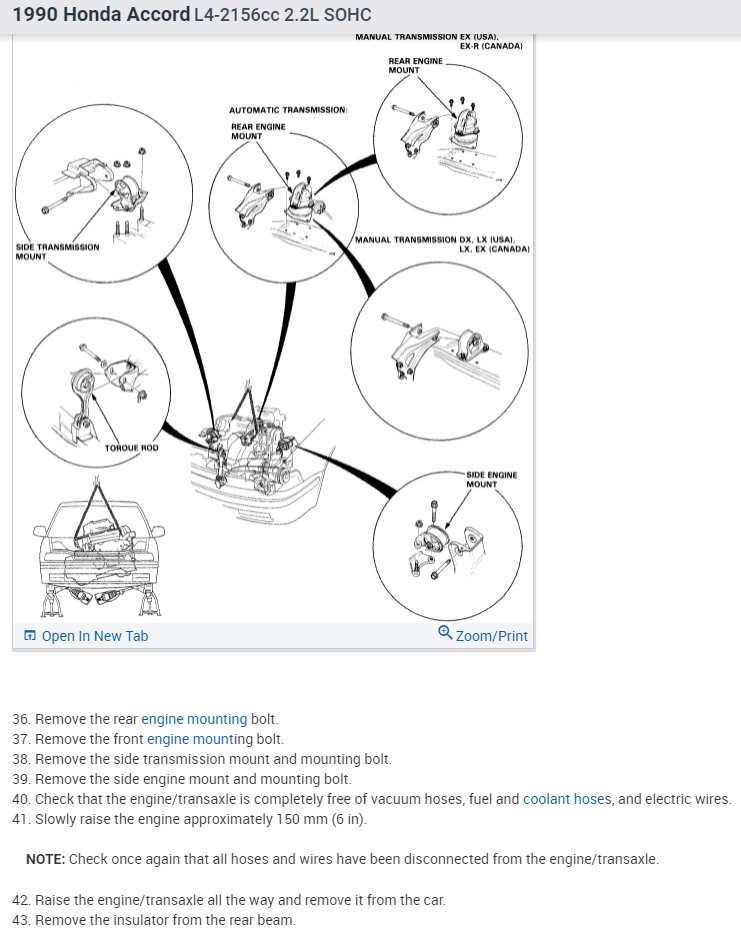

You might run into modifying the motor mounts as they are different.
Keep in mind, this type of swap sometimes requires modifications to components and not a direct swap/replacement.
Here is a basic engine swap video, it covers a different vehicle but many of the steps are similar.
https://youtu.be/zy1CozLgWUQ

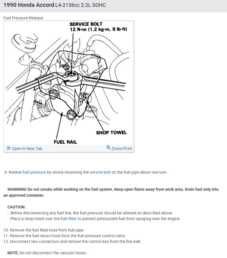

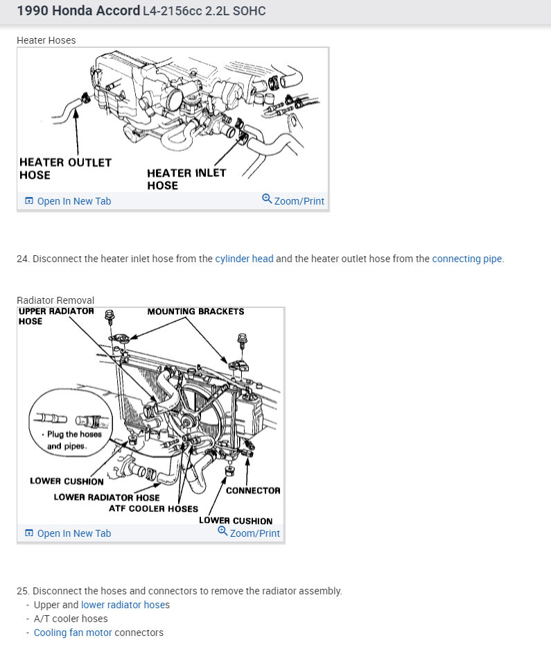

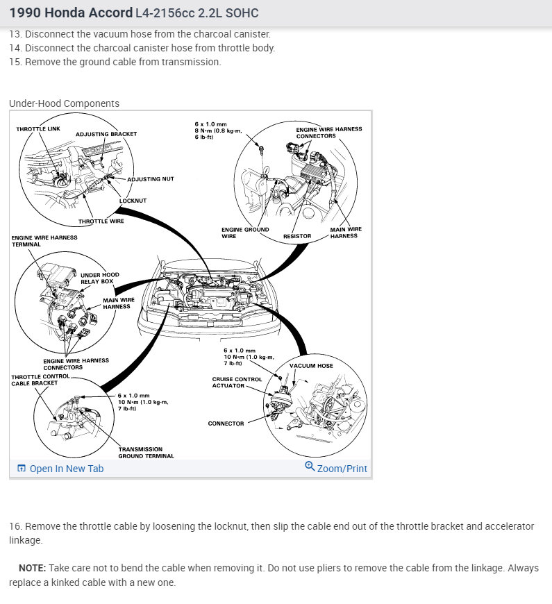

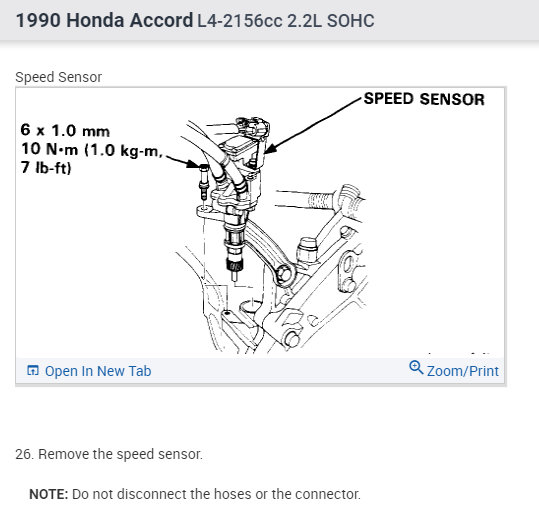

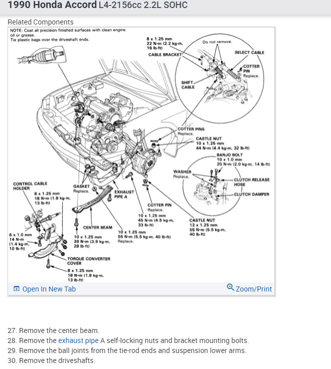

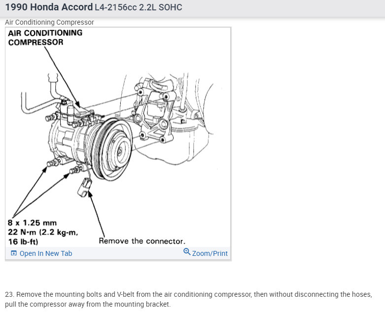

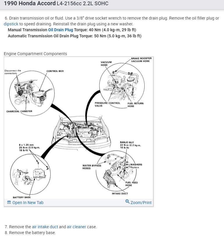

I have attached the standard engine replacement procedure below for reference.
