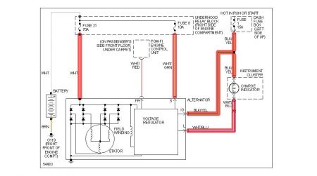

I PUT ON A NEW ALTENATOR BATTERY LIGHT KEEPS COMING ON AND IT GOES DEAD, PUT IN A NEW BATTERY AND BATTERY LIGHT STILL ON WHAT CAN THIS BE

Check fuse 21 70amp/ Fuse 8 10amp/Fuse 1 15amp check wiring connector at alternator and battery connections.
https://www.2carpros.com/forum/automotive_pictures/12900_alty_37.jpg
