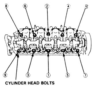

specs on torque for head
Feb 26, 2009 at 10:31 AM
BLUELIGHTNIN6
  • 16,542 POSTS
tighten the bolts in two passes using sequence below. The first pass should bring the bolts to about 22 ft. lbs. (30 Nm). On the second pass, tighten the bolts to their final torque of 49 ft. lbs. (68 Nm).
